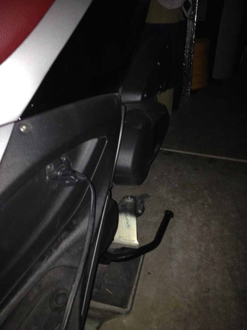

This is what I did:
Installed a Powerlet Luggage Electrix Connector to the lower black panel right above the left side foot rest. I bought the connector at Amazon:
http://www.amazon.com/gp/product/B00206ENZ0/ref=oh_details_o01_s00_i00?ie=UTF8&psc=1
The installation looks like this (forgive the photo):
Works great; I can also hook up my heated vest to the same point.

I forgot to mention the routing; straight off the battery, down the inside of the left side of the bike; no notching of the battery cover required. You do have to get an SAE extension cable from the auto parts store. Cut off one end and attach it to the battery. The other end plugs into the back of the Powerlet outlet. I'll try to get better pics tomorrow.

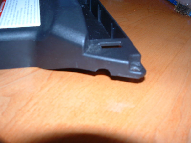

I routed the cable thru the left side of the cover by notching the bottom so there wouldn't be an obvious hole. The cable I used has an integral in-line fuse so the battery is protected.

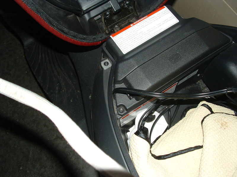

BVEE,
I have a short battery tender lead that has an inline fuse, but I can't for the life of me figure out how to have it connected to the battery with the battery cover screwed in place.
The issue is that the inline fuse housing is too bulky to be fit under the battery cover; can you advise where you have tucked yours that allows you to seat your battery cover fully? That's my big challenge...

I have attached a pic showing the fuse. I stuffed the fuse and excess wire in the space to the left of the battery .

Perfect, wonderful, and awesome. This is exactly what I needed.
THANK YOU!
