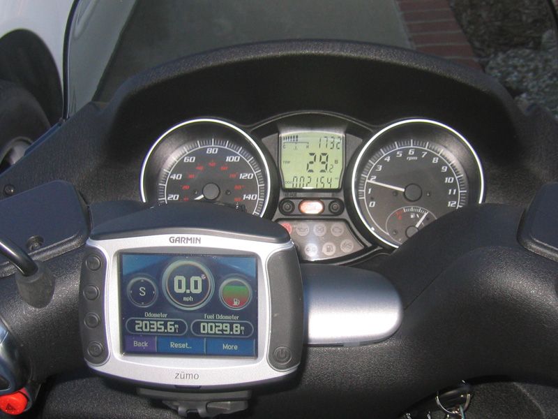

Placement of outlet shown here.
Winter Project List...

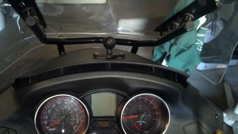

For the Ram mount I used the U bolt clamp on the handlebar. Either side works. A short arm will allow a lot of flexibility for mounting your GPS, or phone, or iPod, or camera, or whatever. I think 2 plugs are a good idea; one for GPS unit and another for heated gear. I use the Powerlet sockets. They are not cheap, but they stay connected, are readily available in several configurations as pre made cables, and are a standard in the industry. As far as other mods, you might want to consider HID headllights, heated grips or the turn signal minders mentioned by others.
Have fun with your projects!

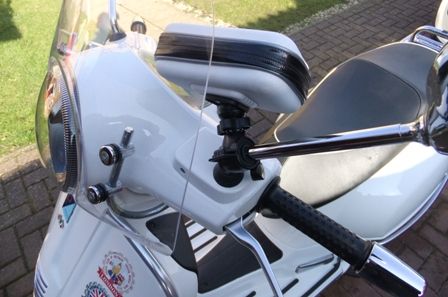

Estaban wrote:
Not exactly, have been researching the options today. Still think the mirror is the only way.
Just found this.... http://www.amazon.co.uk/RAM-MIRROR-MOUNT-9MM-HOLE/dp/B0012TRIY4/ref=sr_1_14?ie=UTF8&qid=1388084215&sr=8-14&keywords=ram+mount
... not sure how the mirror attaches to the bike though and whether this would work.
FWIW I tried a GPS mount on my GTS mirror stem and it didn't work out - the vibration the mount gets when riding was enough to transfer down the mirror stem and break the 2 plastic lugs that you screw through to connect the brake cover to the headset, and I had to repair it. I then went for a handlebar RAM mount with a much stronger (see link) and have had no problems with it since with the same GPS pouch.
http://www.ebay.co.uk/itm/Ram-Mounts-Ram-b-149z-Mount-Kit-Motorcycle-Scooter-ATV-/181255788332?pt=UK_Motorcycle_Parts&hash=item2a33afd72c
I don't know the MP3 set-up but sharing this as a cautionary tale. I know others who've used mirror mounts with no problems...
Original set-up with plastic mount on mirror stem (didn't work out for me)

@14perry avatar
MP3 400 / BV250
Posts: 3809
@14perry avatar
MP3 400 / BV250
Posts: 3809

The plastic handlebar covers on the 250/400/500 Sport make extensions or Ram mount tabs a little tricky.

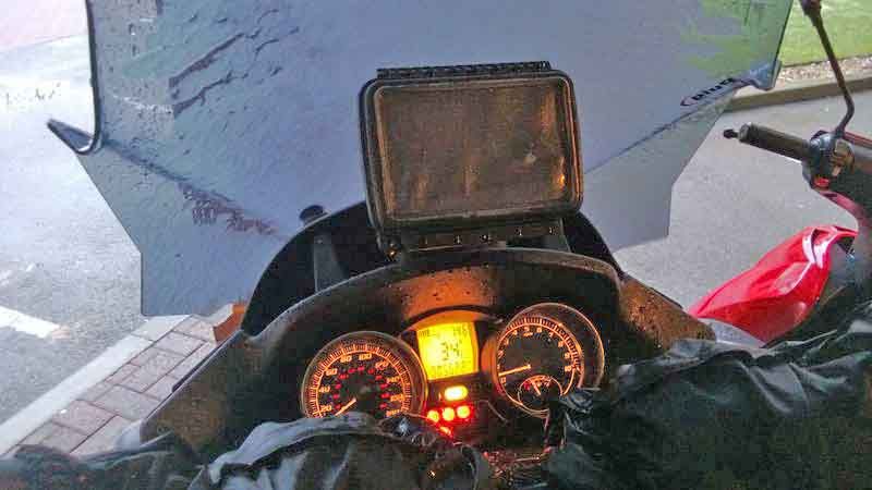

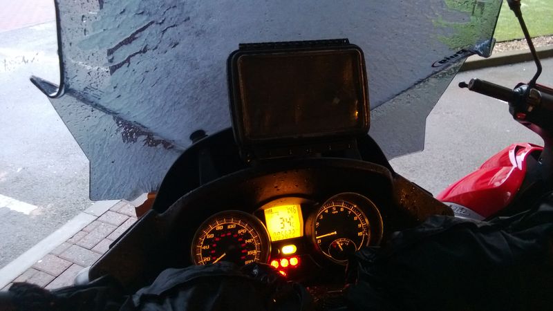

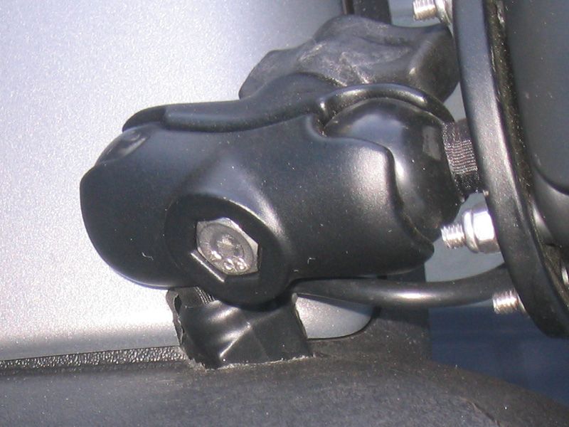

RAM mount
I bought this:
http://www.ebay.at/itm/RAM-Flex-Adhesive-Marine-Car-Surface-X-Grip-Holder-Mount-for-SmartPhone-iPhone-/400295311724?ssPageName=ADME:L:OU:AT:1123
and stuck in right in the middle of the dashboard on top of the back plastic under the screen. Works perfectly to hold my iPhone.

Not sure I would trust any suction type mount with an expensive gadget on the other end.

@helixpteron avatar
Piaggio MP3 400 (2008)
Posts: 35
Location: Noosa Heads, QLD, Australia
@helixpteron avatar
Posts: 35
Re: RAM mount
Estaban wrote:
helixpteron wrote:
I bought this:
It's stick on and not suction - works great for me, just clean the surface well before. It's made by RAM - will never come off . I used their suction cup on helicopter windshields and it sticks, so I'm convinced.
You have decided to not use on anyway I guess. Cheerio.

I haven't just now, so I mocked this pic up instead. The U bolt and the mount base separate to go over the rubber hand grip, are pushed up against the plastic of the headset cover, and are fastened together with the nuts. This is a really stable fitting. This means the mount only takes up about a half inch of the rubber hand grip, leaving plenty of grip for normal use (if you're gloved hands aren't huge). The Vespa grips are quite fat so I needed to get a slightly longer U bolt so the nuts would fit (fortunately a kindly web dealer sent me one for free as a good deed). The ball mounts either end allow movement for best position. I screwed the top mount plate (with the 4 holes) to the back of my original sat nav pouch, and that was that. I just need to do the usual GTS power outlet mod so I can power my Tom Tom Sat Nav for more than a few hours battery life. The RAM mounts have lots of variations so you could just substitute whatever top section you need for your particular phone/GPS etc.
Does that make better sense? I'll take a couple of photos over the weekend and post 'em up...

Got it now, thanks for taking the time.
I have got big hands unfortunately, I will take a look and try and guage how much space I have.

Hi,
I have the same bike as you and I used the RAM mount for my Nokia Lumia phone, which is my sat NAV and phone. Using the large ball you can get the mount in the center storage bin and use one of the weather proof boxes to hold what ever you want.
I have attached a picture of mine (it's a bit dark sorry) but it was a bright snowy day. Before anyone comments, this picture was taken for my dealer to get me a new dashboard, as you will see it thinks it is 34 degrees centigrade with snow on the screen
I used the remains of a Tom Tom electrical kit to feed off the ignition circuit onto a relay and that switches the power to my heated grips and phone so that I don't get a flat battery.

OK, so it is one of these bolted to the panel that is the base of the pocket. I added some tapered shims to keep the curve and routed a power lead under the bracket and fed that through into ram aqua box.
It is currently ever so slightly too heavy with my phone on board, so I am going to stiffen the panel as there is room beneath it.
I stole this pic from the "new guy" thread so this isn't my bike, but it is the same ram base "large ball".
