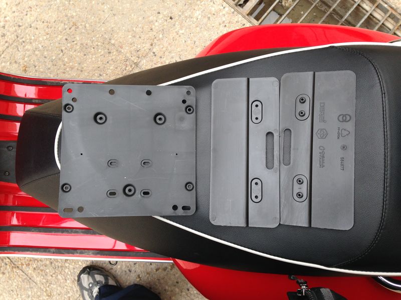

item 1

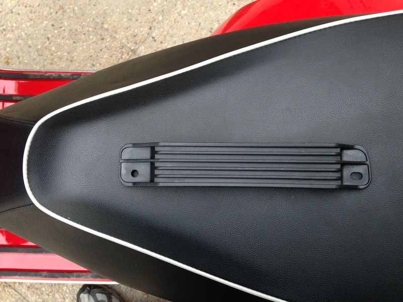

item2, view 1

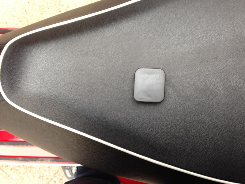

item 2 view 2 backside

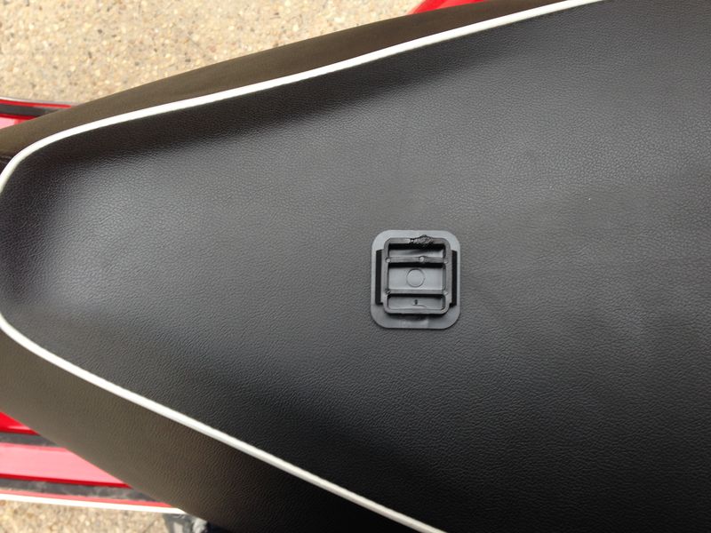

item 3 front view

The second item picture shows the battery strap & this should be holding your battery in place

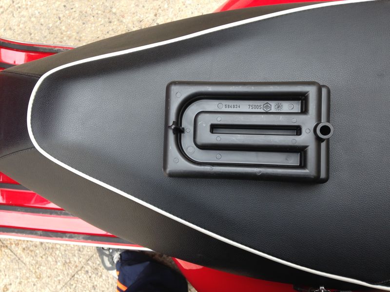

item 3 back view

I guess these are for number plates??

so my dealer forgot to put it in??? can i do it??
do you know what items 1 is for?
thanks for the help super fly

The pic above looks like a cover for an opening along one of the lower sides of the scooter. Look way down. Might be something different on yours but it looks exactly like the one on mine. Can't remember which side tho. Hope that's it. Congrats on the new scooter. 8)

can you specify which item? is it item 1 or item 3?

Sorry it's item 3. When i started to write my answer the pic was above my reply. Guess i was slow.

David, you are absolutely right, item number one is the battery pan and item number 2 is battery bracket.
i just installed both on my own. i also noticed that the engine coolant level is below minimum or non existent. I think the dealer forgot to do pre-delivery inspection.
cheers to all who helped

I reckon photo 3 is the tool case cover - when opening the glovebox you will see a square shaped hole where the tools go - I think photo 3 is the cover - good luck

wombatdolphin wrote:
Hi all
WD
Make sure u hot the tool kit as well, especially the shock adjustment tool.

item 1
not sure what it is. but a goggle search of: 584934 Vespa' pulled this up.
Its a BATH VESPA GT
http://www.motorcyclepartsnetwork.co.uk/inStock/part.asp?gpn=584934&dealer=A.J.Sutton&showSupplier=True
