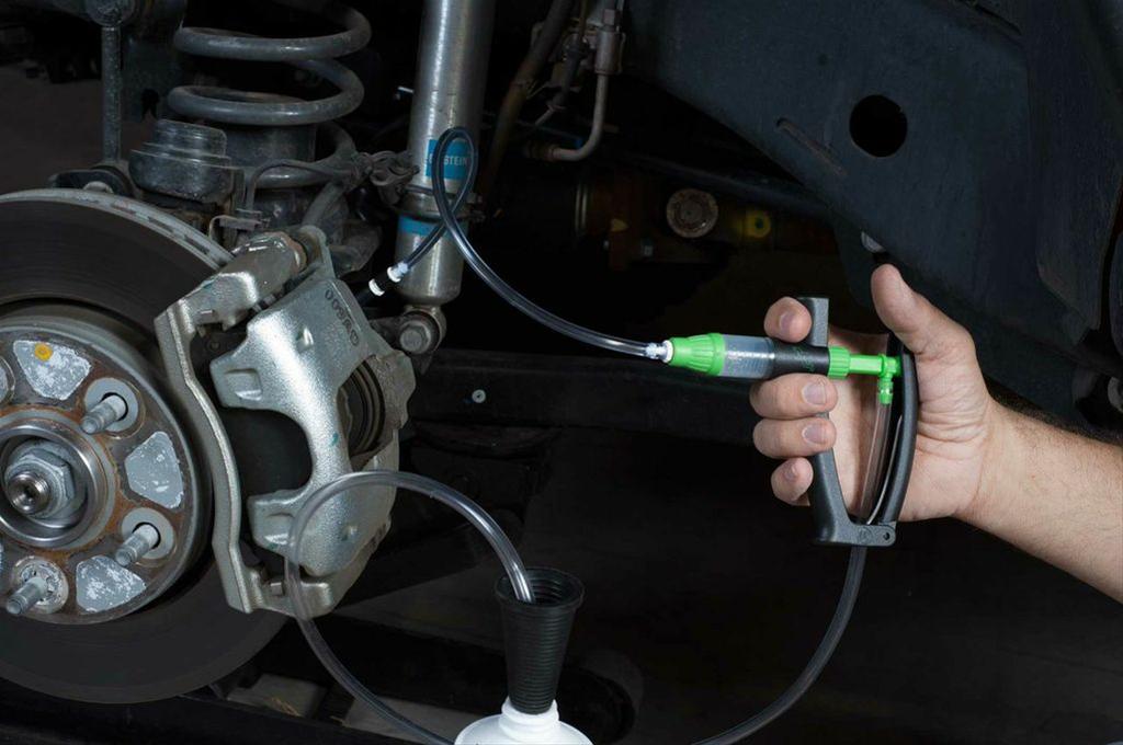

Yeah that is the way I have been doing it. Pressure filling from the nipple up. Using this:
http://www.summitracing.com/parts/psl-2104-b?seid=srese1&gclid=CJXLsrz9obsCFTEV7AodF34A1g
Pretty much just a fancy syringe to push the fluid up.
