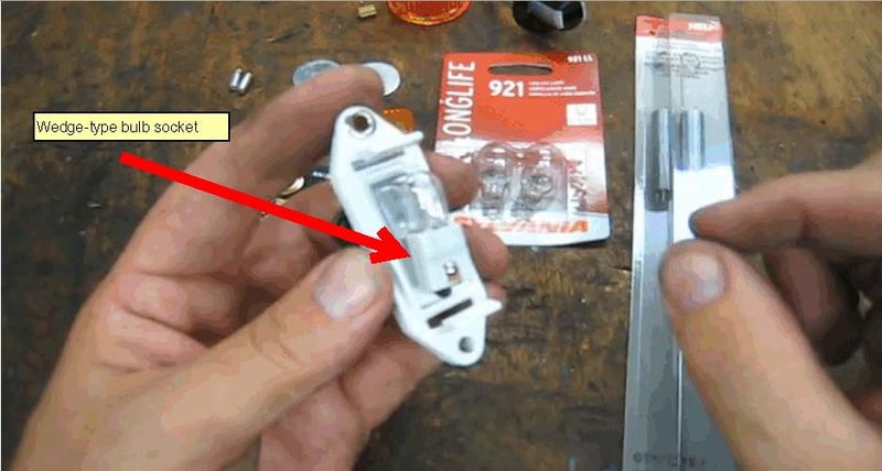

SoCalGuy wrote:
... and how did you do it?
SoCalGuy, I haven't done this but it's on the list - procrastination seems to take up most of my time. The video in the link shows I think THE way to do bar ends. Bar ends look very cool and can be seen from front and rear, meaning no hole-drilling in your cowls.
The video shows how to mount them without the special inner tubes that hold them rigid Or the special handgrips... but they'll turn with the throttle & gear tubes. But the best bit to my mind is they are mounted on springs - no solid fixing so they are much less likely to be smashed by a knock.
https://www.facebook.com/video/video.php?v=1843603133769

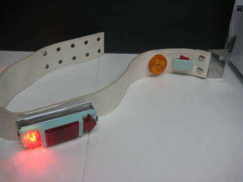

SoCal, I have a '74 Super that came with the original signal stalks and some new after market blinkers. I do not plan on using them. They're yours for the price of shipping.

Re: Who's Added Turn Signals to Their Not So Modern?
Thanks Ginch, this is could be the winner. Holding the bar ends in place with springs secured by washers and those little brass clamps is borderline genius. I was considering using a long threaded rod, with washers at both ends but couldn't figure out how to secure it at the light end.
Tierney, you are too kind! I will p.m. you.

Classic Rider: So basically your signals didn't flash at idle when they were running AC, but switching to an AC/DC system solved the no-flash-at-idle issue. That's consistent with what blackbart says about loads being more critical in an AC system, since at idle power output is lowest. How do you now supply current to your flasher?
On our scooter the flasher is fed off the regulator. The wiring calls for a 6V, 21 watt bulb at each signal.
Notice the guy who modified the bar ends in that video was dealing with a 12v system. He not only swapped out the bulb holder but put a higher wattage Sylvania 921 bulb in it, which is 12v, 18 watts.
Anyone know if there's a 6 volt bulb with similar wattage that would fit inside the bar end system?
This? http://www.ebay.com/itm/BA15s-6v-5w-8w-10w-15w-clear-19mm-dia-globe-straight-pins-Car-Bike-Scooter-/271269904503?pt=UK_BOI_Lights_Lighting_ET&var=&hash=item3f28f24077

Ginch, that bulb might fit inside the bar end lens, but how would you fix a bulb holder in there? Those bulbs have a bayonet base, which is different from the wedge base used by the guy in the facebook video.

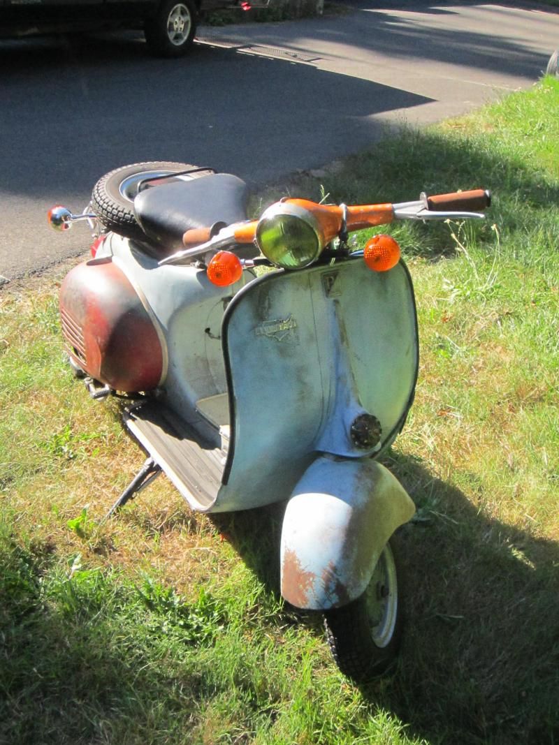

I understand the compromise that are inherent with blinkers. I almost got creamed once because I left mine on but there in lies a tale for another day. I have a turn signal setup that was made for a bicycle. It consists of a box which is meant to mount under the seat. The box has two signal lights and operates on two D batteries, which is good because my VBA has no battery. A switch mounts on the handlebars. Adding two more lights would adversely affect the flash rate but LEDs have a low enough current draw that I think it would be OK. Bar end lights had not occoured to me. It seems to me that they would be visible to the rider when on. Sounds like a project.
You have any pictures VRM? That sounds like a neat idea.

I just had a look at the bar end lights on SIP and the globe is different from the one in the video... like this -
It's a bay9s, a small halogen that doesn't appear to be available in 6V. Maybe time to try Matthew's idea using leds?
