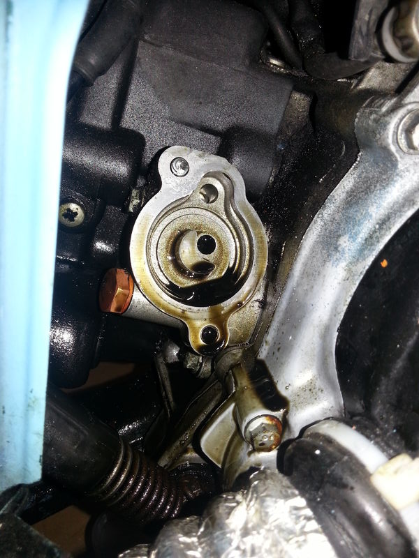

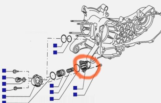

I've had a go at getting the screw out but it's turning out to be quite hard, am I right in thinking that the part the filter cover comes off from can be removed from as it seems to show in the diagram attached, I've circled the bit I believe the screw is stuck in which I believe looks like can be removed from two screws above and below.
Can it be taken off? I think I'll have to drop the engine out otherwise!
Oil diagram
Oil diagram
Photo of the stuck screw

That shouldn't be that difficult to remove. Is the bolt broken flush, is part of it exposed beyond the face or did it break off below the surface?

Not sure how much room you have to work on it but if remember right the ET filter mounts horizontally - I'd try to get a drill or mini drill (with a flex shaft maybe) in there and drill it out, or make a pilot hole, screw another screw into it for grip and try to remove it with that. If it was rusted, some heat from a wallpaper/paint stripping gun or hairdryer on the alloy couldn't hurt and could make the difference to free it.
I wouldn't rush to have the engine out - IMHO it'd be worth buying a mini drill for £30 or so before that if you didn't have one...

There's a bit poking out but not enough to get a good grip with the mole grips!
Cheers, I'll have a go at it and report back!

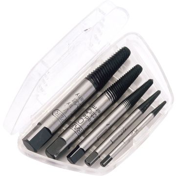

best bit of kit i ever bought was a set of draper extractors .... drill hole in center of snapped screw n put extractor in cordless on slow n remove ... if it losses grip move to next size up .... take it slow n dont start kicking scoot
