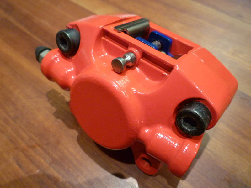

...and a picture of the painted brake calipers

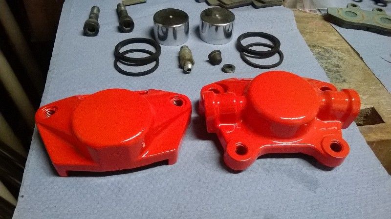

Finally got the seals...
Problem solved
I first tried that Parker-link (yes, they have a reseller here in Finland), but they did not have oil seals... then I called a car brake specialist, but they only had oil seals but no dust seals (car brake calipers don't have dust seals?)
Then I took a long shot and ordered couple 30mm oil seals from Ebay. And they were exactly same sized as the originals (both oil and dust seals). Lucky me
