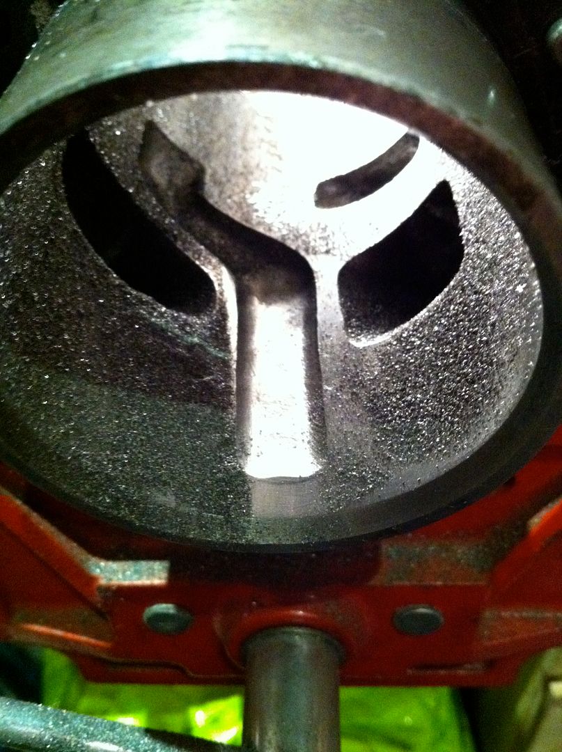

boost ports are part of the reed block (see pic above). no real need of a grinding extravaganza....
