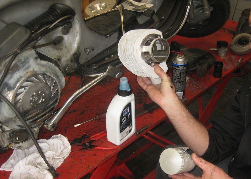

So I just received a new Malossi 210cc cylinder and head from Scooterwest, I opted for the sport version and not the racing. The unit is very light and the color of the metal is like a very light gray color(almost white).
The piston rings are very thin and sharp to the touch. I compared the piston with another Malossi 210cc older piston that I had laying around and they are identical in shape,size and markings (except some digits on the top off the piston).
The kit went in very smooth, a true bolt on. I didn't bother to do any work on the engine cases because I never intended to do such modification but if I ever have to split the engine cases for other maintenance I might take the challenge and do some porting.
The engine started after 5 or 6 kicks (we shut the fuel lever closed during the install). This kit came with a 130 main jet but I opted for a 125. I am at altitude (2600ft) and from previous cylinder kits and expansion chambers and exhaust experiences it seems like the 125 main jet with the 24 del Orto carb works ideal on my situation.
The response in the lower and midrange is noticeable/instant, you can feel more torque even if this kit is intended for higher rpm power. I probably revved the engine up to 50-60% of its potential and I put about 45-50 miles already. The engine is now starting at the first or second kick and the idle is very stable. The engine sounds at half throttle like beging you ton rev harder. I am running a Sito plus for now.
I am very excited about giving you guys more feedback as I put more miles. I chose Scooterwest as my vendor because they have a great customer service, extensive knowledge,rapid shipping and good pricing(m opinion). Besides that, I have been on the store myself and the shop is a world class facility.
This my my third Malossi kit and now I feel very solid about the quality of these kits, definitely a nice upgrade to your P200. Here are a few pictures that I took during the install. I was running a Pinasco head on a P200 cylinder, the head was from a previous kit.

Thanks for sharing. I've been dreaming of Malossi kit for some time. Is your kit called "Sport 2013", article code 3115618 ? Cylinder head looks interesting as well. Spark plug seems to be at center, but angled. Can you still use original cylinder cowling?
^^yes, that is the part number of the sport model. I don't know what the cylinder cowling means.

I mean the black plastic cover which deliver cooling air to cylinder and cylinder head. Can you use it as it is, or did you drill another hole for the spark plug?
Nope, It fits well (the factory one I mean). This kit is a "plug and play" sort of speak, no porting needed and bolts on fine on the stock exhaust.

That's probably why it is a centered head but angled, so you can still use the standard cooling shroud
