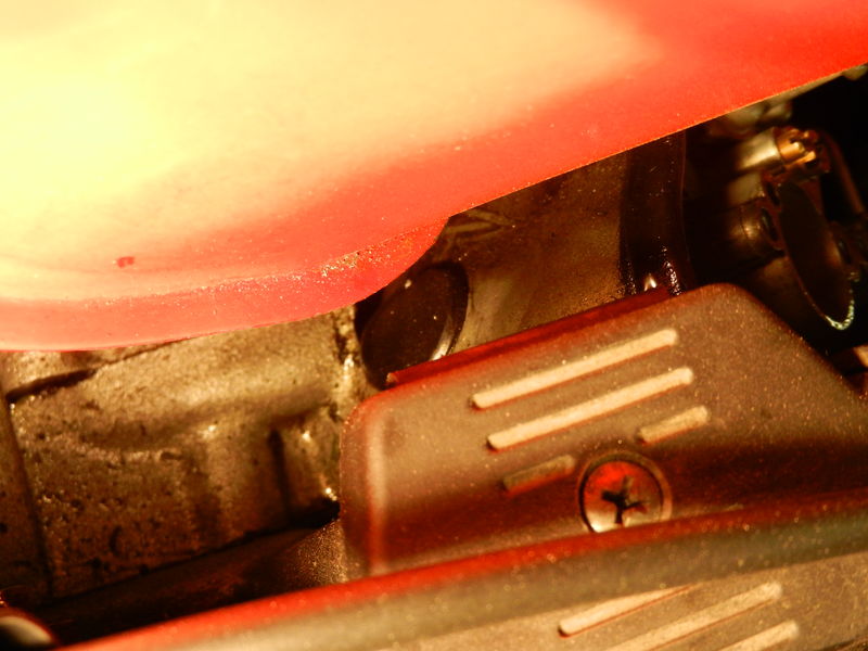

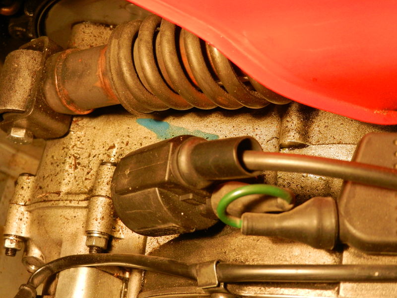

Drippage off the gearbox for a while now, have been collecting it in a pan, it looks like Motul 2 stroke oil, there's quite a bit of oil puddling off the back of the engine coming down from the rubber plug at the back of the airbox.
I took the airbox cover off and noticed fuel puddling at the back of the airbox. Must be that the gasoline mostly evaporates, leaving only the Motul to drip off the gearbox onto the garage floor.
Does this mean I need a carburetor rebuild?
lotsa drip
lotsa drip

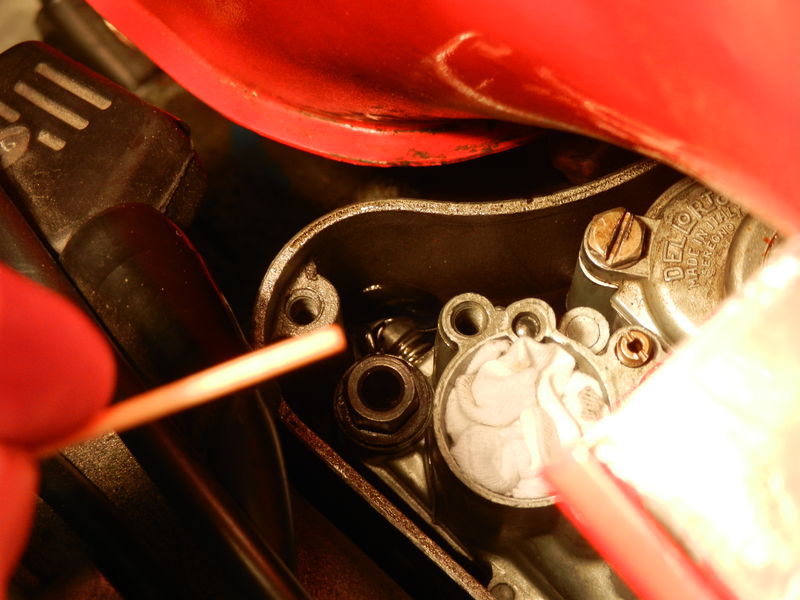

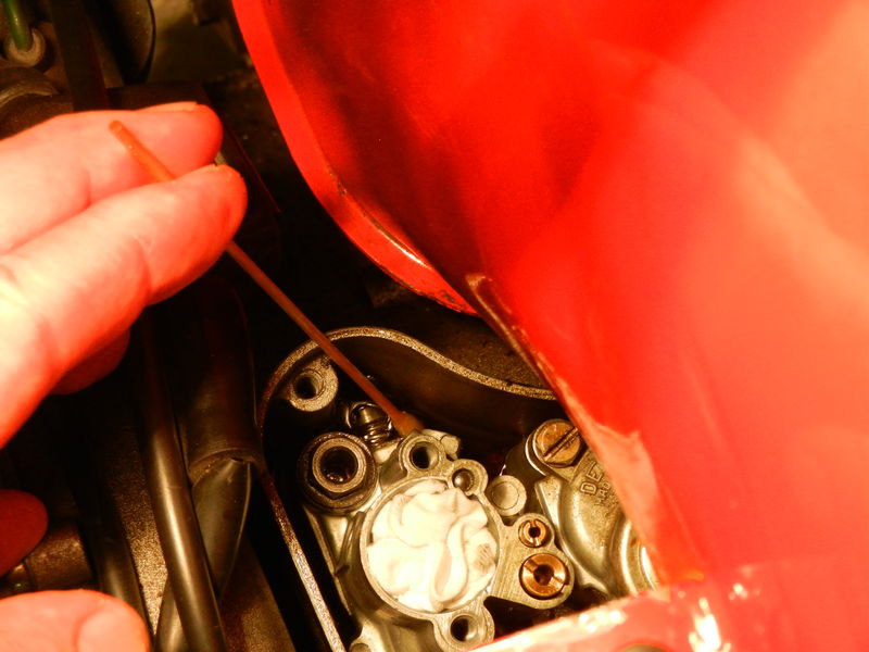

fuel collecting in the lower part of the airbox is close to 1/2" deep

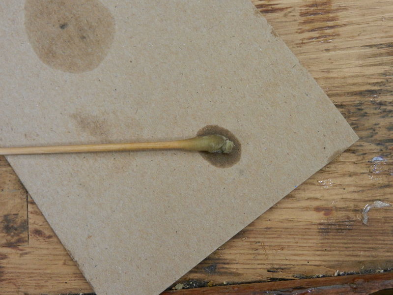

The end of the Q-tip pointing to the adjustment screw almost fully immersed in fuel at the back of the airbox

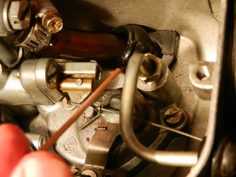

The oil line and the fuel line are wet at their entrances to the oil pump and throttle body
Smells like gas and Motul 2 stroke oil

Check to see if the screw where the fuel line connects to the carb is tight or wet for that matter. You could nip it up an 1/8 or 1/4 of a turn. Being aware that too much could strip the thread (ie half a turn)
That sorted mine

looks like the grommet at the base of the carb box around the fuel line has had the dick
if you take off the spark plug lead and air filter then kick it over you'll see fuel n oil spits out the top of the carb

That's too much...look for a fuel leak. There should be a washer under the screw where the fuel line attaches and under the banjo. Also, make sure the float bowl washer is doing its job...

First thing I'd try is tightening up this clamp, as mentioned above. Area looks wet.

Solved the problem, I think
I went to O'Reillys Auto Parts and bought a sheet of thickish paper gasket material ($6 Line item FEL Number 3046--more gasket material than I'll ever need in my lifetime), pulled the carb (intact) off, traced the pattern of then cut out the base gasket; put it all back together, made a test run, no more leak.
The leakage was oil and gas, so it kinda makes sense. The only defect in the carb box that could bleed out oil-gas is a leaking base gasket or a warped carb. Nice call Aviator47.
