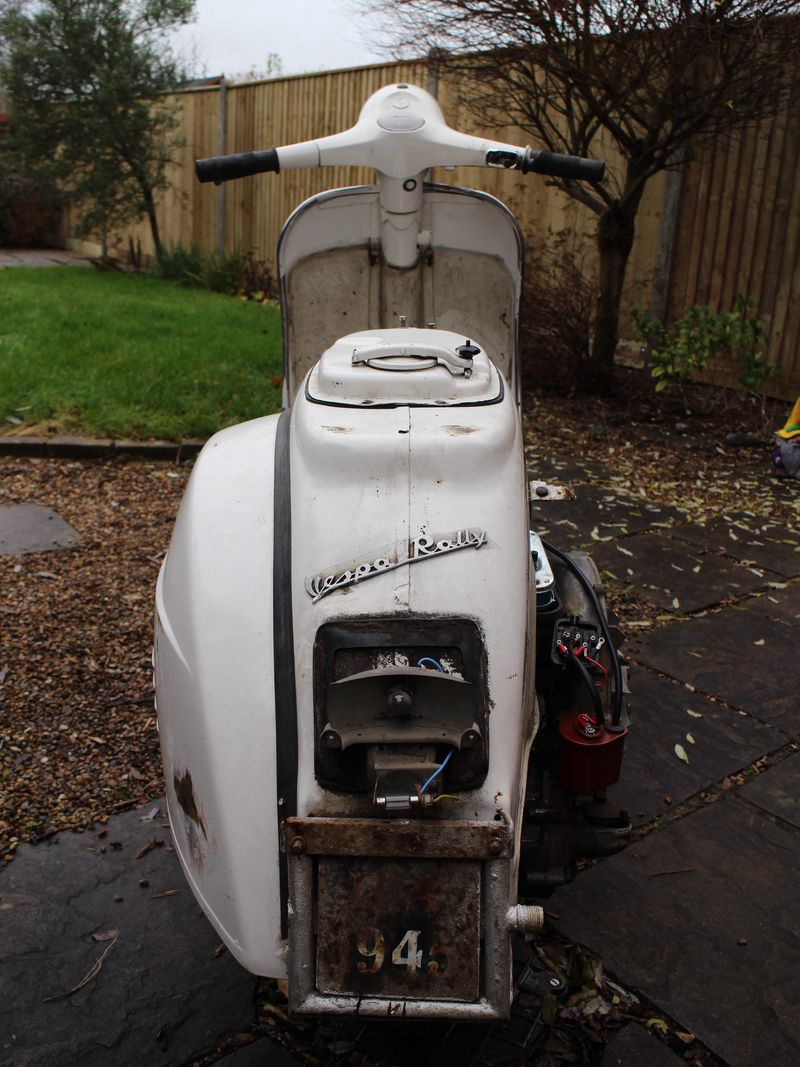

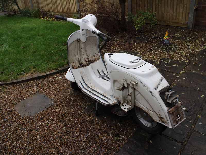

I spent some time late last year looking for nice project scooter to restore.
In the end I picked up this 1970 Rally 180. Engine and frame numbers are matching. It was not running.
It has be imported into the UK and poorly painted in past.
Originally I was planning to get it back on the road and do the rest of the work gradually. But the more I do, the more I think I should just strip and rebuild.

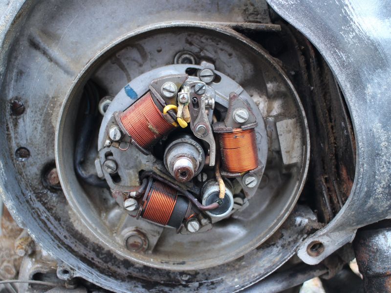

Originally got no spark. Spent some time rewiring the stator. Stator plate was fine. Just an issue with the cabling. Engine ran, but had a bad fuel leak from the carb.

So far the exhaust has been replaced, the old was holed.

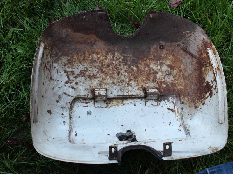

The glove box has some surface rust on the inside, was tricky to get off as the fixings were rusted, ended up cutting through the bolts with a dremal.
And I've started to remove some of the non original accessories.

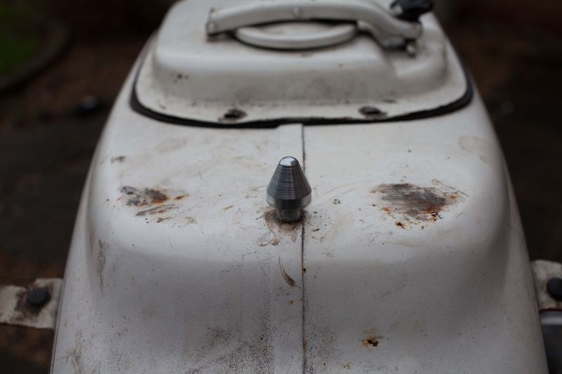

I had some fun with the seat post, the previous owner had snapped the bolt, and just painted over. So the seat was not held down, seems odd to me. I believe thats an MOT fail in the UK. I tried to drill out the bolt. Had no luck with left hand extractors, in the end I had to drill right through, widen the hole and then re-cut the threads. Seems to be nice and tight.

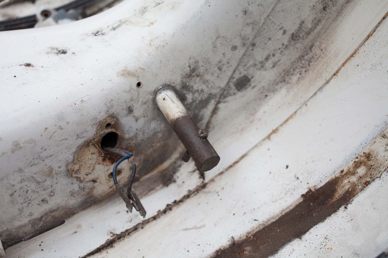

Still got an electrical fault on the brake light, thought it might have been the brake switch. had some problems getting the rear brake pedal off. the pin seems to be rusted solid.
In the end I've had to cut most of the pedal away. the pin is still left and not budging, looks like I'll have to drill this out too. anyone know what the hole diameter is?

Brake pedal pin problem is a very common thing to come across, notice you have a box from SIP in the background, don't mean to be an ass at this stage but some of the after market stuff they supply is crap (hope I haven't offended any one on the forum). Great project though, where abouts in London are you matey.

Good to see another member bringing a Rally back to life. There's a few UK guys like me and GTR71 working on these large frames and swapping a few notes through MV. I had the same brake pin problem on my '75 GTR that I got out in the end (pics on my thread). The GTR and the Rally share the same frame bar a few points like the toolbox.
