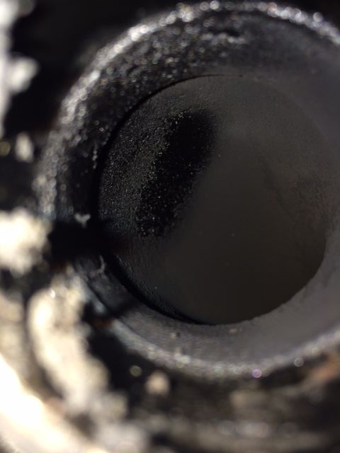

This engine looked factory new clean when I installed it 1K miles ago and still did several hundred miles ago. Now there's black chunks of crap falling off of everything, and the exhaust was partially blocked with it. I don't know if the exhaust is even still usable.
I ran out of paper shop towels and gloves, so this is as far as I get for today. Sometime later this week I'll dig deeper and post pics of what I find. I suspect the combustion chamber is totally crapped up, which would explain the climbing compression readings.
Thanks for following.

leaky leaky = dirty dirty
that is a lot of coke buildup

No kidding. I've never had this problem before. Too much fuel? Too much oil? Too much of both?

If your exhaust is as choked up as it could be, judging by the pics i think you may have found a large piece of the puzzle for your original issue.
Oil all over - maybe like the 2T oil check valve isn't seating and oozing all over the engine inside & outside & fouling your cylinder plug & exhaust ? Doesn't that piston crud looks like oil rather then rich fuel? Oil crud on the plug can explain the poor running.
