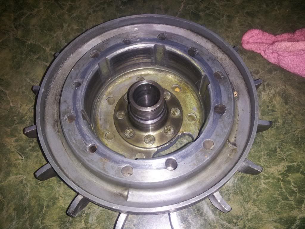

More options
Biggy,
Lots of good information HERE if you missed it, including info on plastic fans and cut down stock fans.
stock fan @ 2.72 kg & plastic combo @ 1.43 kg.
cut down stock fan @ ~ 2.2 kg, turned & balanced by Hot Rod Al

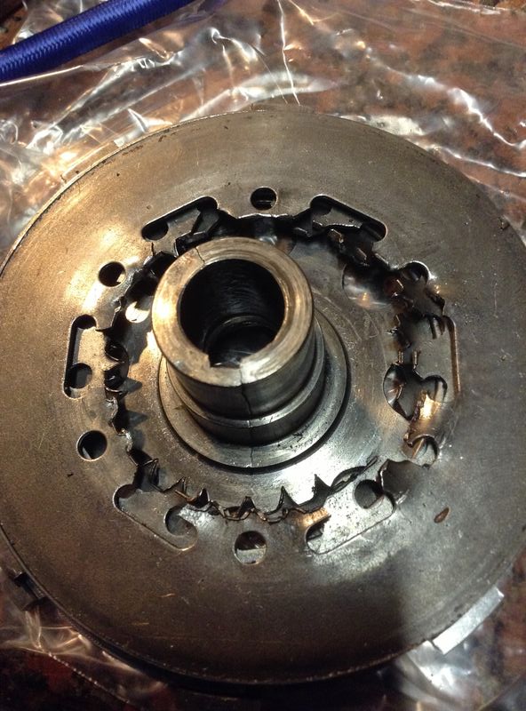

With only one cylinder on a 2T you have all the torque and power being produced in 1/4 of a revolution. At a minimum the total mass of the crank, flywheel (and clutch on the largeframe) must store enough energy to complete the other 3/4 of the revolution. The torque and stress that the clutch, primary gears, and cush gear see is not the average from the dyno but the 4X that average that is delivered in the 1/4 of a revolution. Even that is not the max, the torque ramps up and then down so the total stress would be about 8X if there was no flywheel.
So the practical limitation is on the wear that the clutch and cush gear take. I'm sure there are ways to calculate and predict this but it's probably easier to wait till you have a problem and then correct it.
On my smallframe I ran an HP4 flywheel and all the cush springs are broken and the tabs of the clutch plates are chewed up. Empirical evidence that the HP4 is too light for endurance racing.
As for balance, I don't buy any of it. If the flywheel had to balance the clutch in some way then the smallframe (and every motorcycle and lambretta) would be "unbalanced". As long as the flywheel itself is balanced all will be well.
There is some validity to a heavy flywheel increasing stress on the crank. This comes from the fact that the flywheel that's storing the energy is on the opposite side from where it gets delivered. So during the power stroke the fly side taper is stressed in one direction and energy goes into the flywheel. Then the taper is stressed the other direction as energy flows out again.
