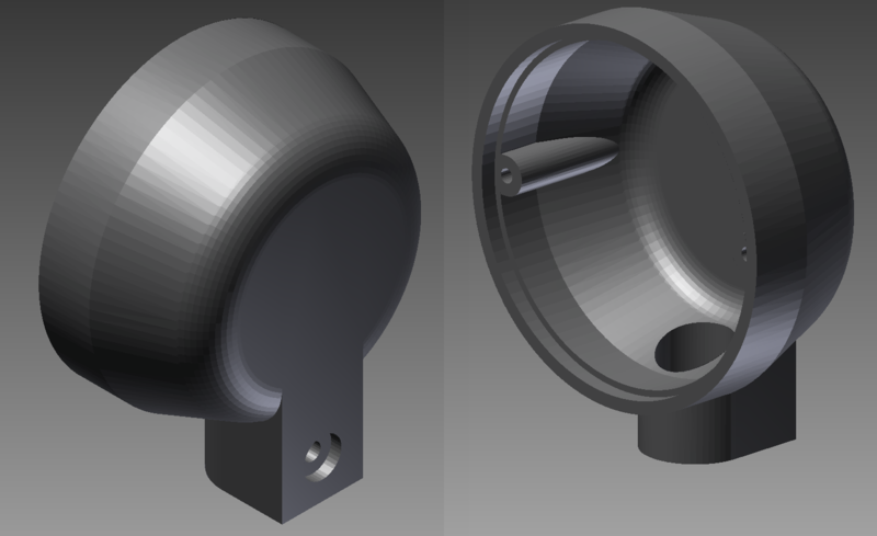

I created a 3D model of the turn signal housing that I want to get 3D printed to see if it would work and check the fit. Then have them machined out of aluminum.
i have to ask, is there a reason you're going custom rather than off-the shelf?
there are standard assemblies available that are pretty much identical to that.

rob hodge wrote:
The off the shelf ones don't quite look like the originals and the originals are plastic. Plus I wanted to have something unique.
