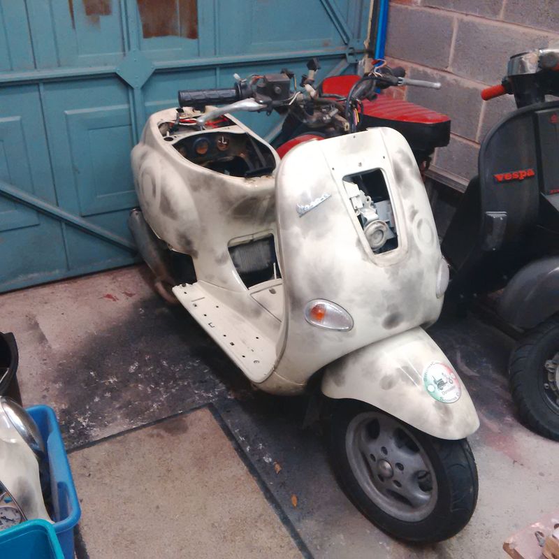

Hi
I'm hoping you can help point me in the correct direction with this....
I'm in the process of swapping the components out of an ET4 from a rotten frame... to a solid one that I've repaired and painted....

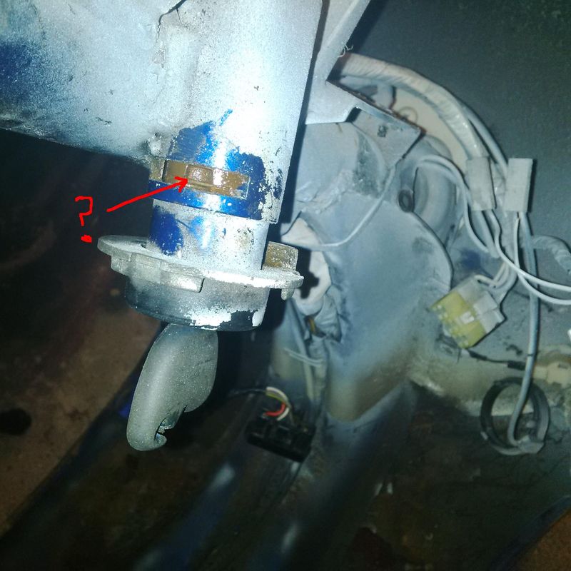

....a problem that I've come across...I'm struggling to remove the ignition barrel from the barrel tube....I'm sure that there's a clip that holds it in but I can't budge it so I'm assuming that I'm doing it wrong....

This?
Posts: 9512
Location: Main Street, Watts
Posts: 9512
Yes.

Motovista wrote:
Yes.
Why won't it budge???
Should I be pushing it in with a flat screwdriver....or pulling it out with some pliers? I'm guessing it should be pushed in and its just seized up?

Solved.....just used a flat screwdriver on the clip (indicated with the arrow), some WD40, and a sharp tap on the screwdriver with a hammer...that did the trick....

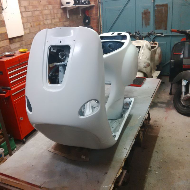

Is that your black bike to the side. Looks lovely from what I can see!

oh mate, that is the bee's knees! You done it yourself or get it like that?
