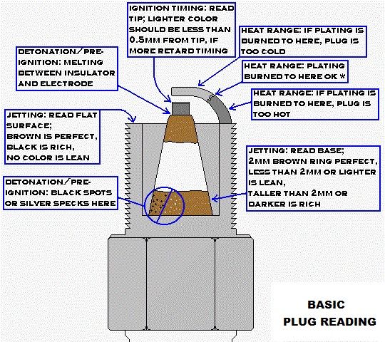

Yes. Both base and tip.
I use this as a reference.

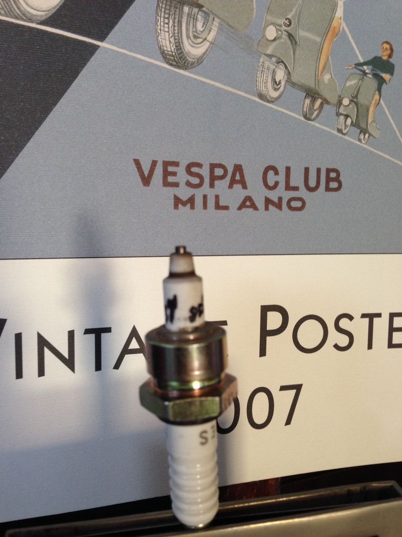

ok, ok... after running wide open for about a mile you have no ring like this?
Have you done a leak test? Have you had a whif of your gear oil to smell for gas?
IIWY, I'd get it running and spray some starter fluid carefully into the joints of the cylinder and the case and the head and the cylinder too.
If your plug is just white w/ No ring at all, you're sucking air somewhere.. based on a 145 main jet on a stock 125.

put in a new clutch side seal, new fly side seal, new cylinder base gasket sealed with silicone gasket, and sealed the head with silicone gasket.
plug chops after mile long runs at WOT still showed white.

I'm guessing 145 is the biggest jet you have? Otherwise you would have kept going up (even though you know it's too big) until the plug started to go brown. Something you might like to try.
There was another thread here recently where someone was running a minimum 20 jet points above everyone else... didn't seem to be any reason for it and I don't beleive he got to the bottom of it. Ran perfectly like yours.
Thanks for the plug reading image! That's going up on the wall.

So here's a pic of a chop i did tonight. This plug has moderate use. I put it in new and then went for a 15 mile ride both through town and out in the country. Then did a 1 mile WOT pull on it and chopped it. It's a B8 and i would eventually like to run B9s but i bought out the town already.
I finally got something other than white..... Stack is 140/BE4/145
Thoughts???
