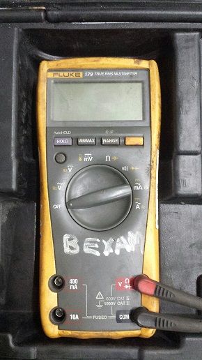

im in work and can use a multi meter
How do i do this and what setting on multi do i need?
Soz im no electrician you see?

jimc wrote:
Your best bet is to find a mate at work who knows what they're doing with electrics.
Hi Jimc
a fitter has tested the relay and it read 22.7?
Hes asked me to find out if thats a good reading or not for a Vespa relay?
He thinks it should be around 74?
What`s your view
Thx

carl030370 wrote:
Hi Jimc
What`s your view
Thx
The important thing is if the relay 'makes' when volts are applied, and if then the contacts become a very low resistance (a short-circuit in effect). I don't know the coil resistance off-hand - I would expect it to be several hundred ohms.
