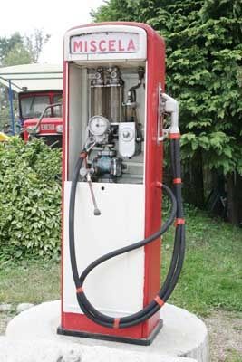

In Italy a long long time ago gas stations had special pumps to serve two stroke engines. Remember how we had to specify what percentage of oil we wanted? I bought two stroke mix direct from the pumps for years and never gave a second thought to what I was putting in my Vespa...
"Miscela" means mixture and we took what we were given, notice the two hoses, one for gas and one for oil. These old engines are tough especially if you avoid anything synthetic you will do okay. Engineers have a deeper understanding of this issue but for me non detergent for the gearbox and non marine (TCW) for the engine keeps me honest.
