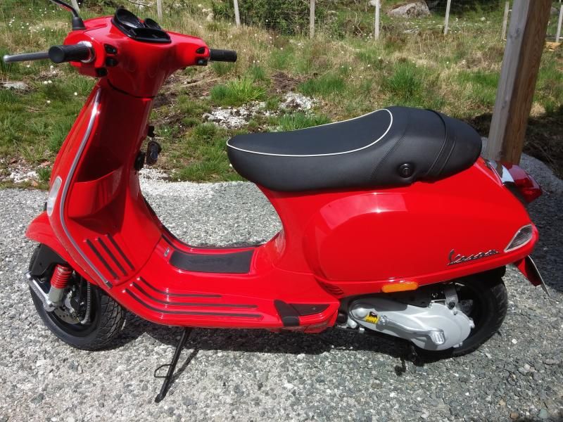

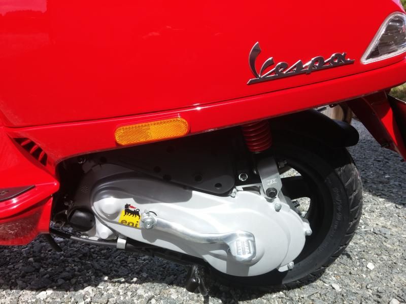

What do you guys think of this baby ?
Runs about 65 km/h on speedo (45 km/h uphill and about 70-75 km/h downhill)

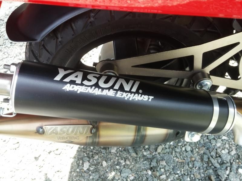

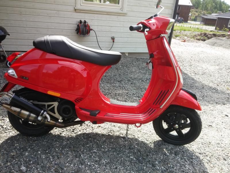

Finished with the tuning. Goes like hell edition
MHR Replica 70cc setup with Yasuni R exhaust. Runs through the speedo in no time.

Excellent looking little scooter. I like the chamber, and how it's low and made so it won't hit the side cover. How do you like the Yasuni compared to other chambers? The only Spanish pipe I've seen a lot of is the Tecnigas, and I would like to put sojmething like this on the kid's ET2.
Did you change out the final drive too?
Posts: 13
Location: Norway
Posts: 13
Location: Norway
Actually the chamber is not that low. You have to use a 40mm or 60mm riser on the shock to keep it away from the sidepanel. I use a 40mm.
It performs excellent. I could not be happier about it. And i love the looks of it. Revs high though! Yeah i have changed the gears. 15-48 Primary. stock secondary.
