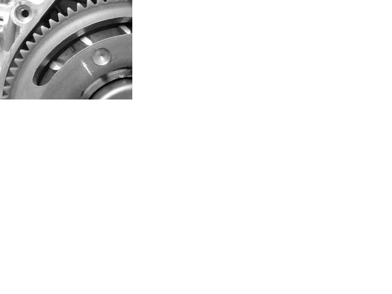

http://members.modernvespa.net/salty_dodd/uploads/34_re_assembly_starter_gear_w_nut_213.jpg
Does anyone know where these arrows are for...???
Thanx:

Welcome to the forum Markiemark! The arrow in the picture next to the green paint dot should line up with the mark on the outer half pulley. The instructions are on page 131(10.7.24) of the workshop manual.
