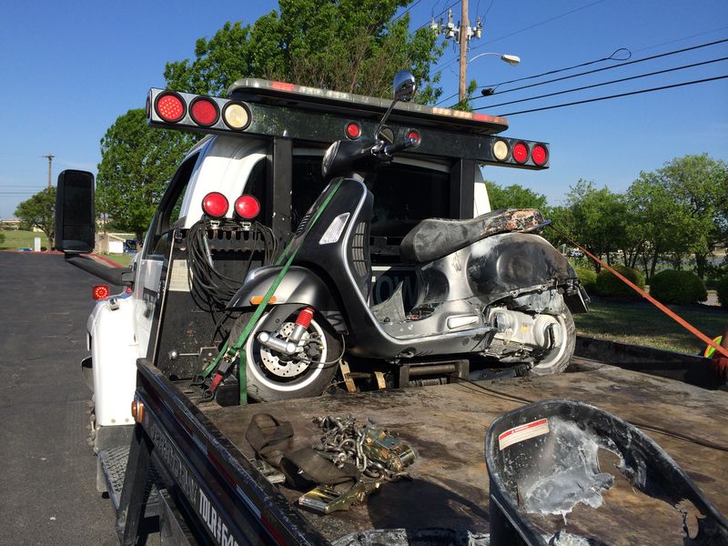

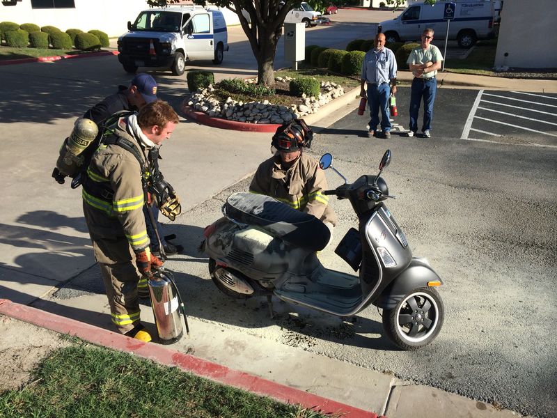

On my way home a car started honking at me like crazy. I slowed down to turn and look at him when I smelled the unmistakable smell of melting plastic. I pulled over and called the fire department. Unfortunately the damage was already done. I'm fine, but very sad.

What's going on with these, its not the first or 2nd one I've seen a toasted gt/gts

Sorry for the loss! Electrical fire?

What the Heck happened ? I can't imagiine why it would just light up like that.

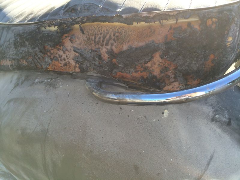

They couldn't tell what caused it. I just got it back from its first service so I thought everything would be perfect.

Ooh, bad news. Sorry to hear.....and a new one to boot. Curious along with others what caused it in the first place. Hope you get it sorted....insurance, hopefully?

Not sure what the warranty period is over there, but I would expect that this would be a replacement by the manufacturer. If there was an issue with the service, was the service done by the dealer?
Anyway, I would expect that insurance payout would result from an accident, but manufacturer responsible if the goods failed due to an electrical fire or fuel leak fire on such a new vehicle.

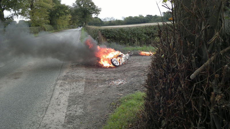

you think thats a fire
Sorry to see your scoot go up in smoke, mine went up whilst joining the motorway at 60mph, i did not have a chance to compleatly stop, i stood on the seat and bailed,

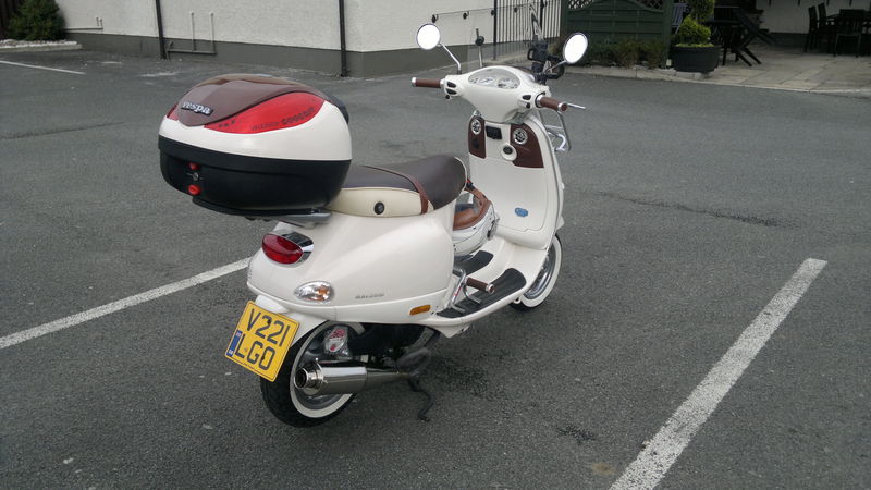

just found more pics
This was taken about an hour before, after a full bare metal, last nut and bolt restoration which took me 4 months to complete
Before.......
Before.......
After......
After......

great balls of fire
I forgot to mention i had just filled up with super, ready for a 45 mile haul up the motorway, at the time of it happening i could not figure out what had happened
It was only when i put my riding gear back on a few days later i found the cause, it was there in my pocket all along, the et fuel filler cap!.
So the moral of my tale is
Always put the tank cap back on Razz emoticon
Cheers
Atb

Talked to the insurance adjuster. They think it is probably a total loss but they won't know until they take a closer look at it. They took it to a lot today to investigate and evaluate. I'm still in shock of the whole thing.

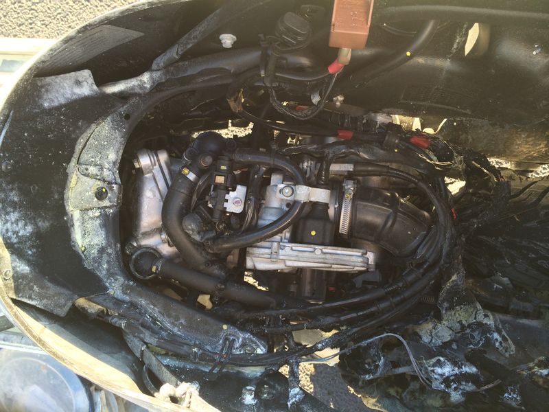

Looks like an electrical fire considering all the melted wire and cabling in that localised area on the right of picture.

cause of your fire
Hi, having seen your pic post fire, your fuel return hose from the fuel injector has sheard, the length of the pipe is 1 inch to short, i bet the other half of the injector pipe is still in the return hose.
This is the third one i have encountered on a gts, if the fuel line is just 3mm to high (due to the metal retaining loop being a few minuets out of true) it will rub on the pet carrier bottom, causing fatigue to the plastic eventually causing failure.

Having experienced gas leaking all over a hot engine, and gas leaking on a hot exhaust pipe, this is shocking.
The 3rd gen Mazda rx7 has fuel injectors above the turbo/down-pipe and sometimes they would catch on fire from leaking injectors.... But the 13b tt engine is notorious for running hot.

Tow truck came to get him this morning. I hate goodbyes. Especially under these circumstances.
I want to cry but I'm still too shocked this even happened.

That's just brutal to look at, I'm so sorry for you. I hope that either Piaggio or your dealer does the right thing and step up for you...if your insurance company doesn't do so 1st.

Damn that is horrible. What was that small piece of wire that keeps getting hot to the point of melting itself, i have seen it here a few times. Could easily be just that.

up in smoke
Hi, shooter, i dont think the mileage is an issue, it is all about fatigue and stress on a part that was not designed or intended for any stress to be inserted on it, the dealer or "human error" WILL be blamed for the fault. Trust me or do the measurements and maths, under that pet carrier there is very little room for error.
Or just look at the pictures take into account what i have said, look at your gts and go figure.
Cheers
