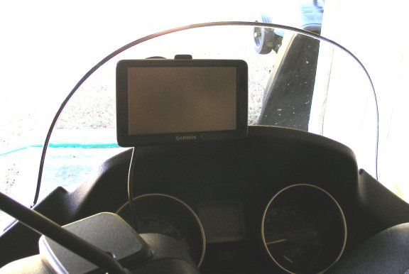

I needed to have a 12-v source for my GPS on my MP3 and did not want to go through all of the pain of running more wires. The photos show my method. I have a small rechargeable battery (WKA12-1.3F) and added a standard 12-v outlet from an auto store. I found a small ladies wallet thingy that fit the battery etc. and hang the stuff on to hook eye beneath the handlebars. The GPS is mounted onto the windshield. Works fine.

You know sometimes the best ideas are the simplest!!
Thanks for a great tip and pics,easy to use and security is not compromised guess I may have to root through my partners stash of handbags 8)

How long will it last? Welcome to MV btw.

Interesting approach. But I am not seeing a fuse or circuit breaker installed - very dangerous without circuit protection. A short circuit or overload could result in fire, easily. Get an inline fuse, maybe 2A (check what gps requires) and install.
So far, 4 hours with charge still left. I haven't run it 'til the battery is dead.

BravoTwoFour wrote:
Welcome to MV.
This GPS pulls milliamperes and everything is exposed. I felt for hea once and there was absolutely none, so I'm not worried about fusing this one.

Bikeguy wrote:
BravoTwoFour wrote:
Welcome to MV.
There won't be heat until it shorts and melts. A fuse isn't there to protect your GPS, it's there to protect the conductors.
