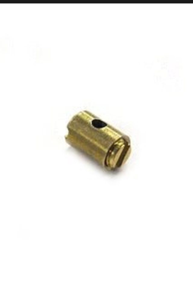

The cable I have will use a pinch bolt on one end (bare wire..) and it has a small nipple on the other (the nipple is a little smaller looking than some I've seen for sale.. The fixed nipple end - goes to the carb side?
I read to thread the cable from the head side (thinking the soldered end stays there and the pinch bolt on the carb side). Now I saw something that makes me think that's backwards.
Can someone verify which end will get the pinch bolt? Also, anyone have a pic showing the pinchbolt in place on the end that it goes on? IE if it goes on carb side - any pics showing the cable fixed with the pinch bolt in place?...or if it goes on the upper side - any pic of it there?
Sorry to keep asking - once I think I have it figured out it doesn't make sense. As always thanks...

Little nipple goes on the carb side.

This is what you need for the headset end. They are a little trickier than using the fixed top and solder on bottom but a little patience and dexterity and you'll get it. [/img]

Arrrrgh.. I have the cable in backwards.. guess I'll pull the inner and feed up from carb side leaving nipple at carb. I do have the pinch bolt.
Any pics of the pinch bolt on cable at the throttle side? That should be the end of my mystery and then it's game on!!
Thanks for the clarification..
