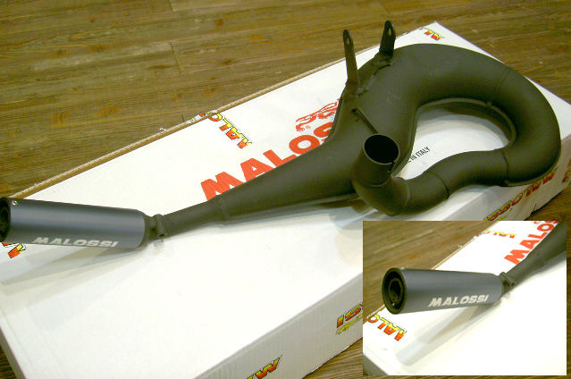

well friends, i still need your help.
i couldn't stop myself from buying small set ups for my vespa.
bought a Malossi exhaust, a pollini air filter and a BGM fast fow fuel tap.
as i was saying, my engine is stock.
i have a 20/20 carb instead of the 15/20.
now, witch jets do i need?
thank you all

Got a jet kit and a couple of idle/mixer tubes?
thank you all
Well at least you know what hardware upgrade youll be using.
Rob and others have suggested the correct tuning advice for you.
It still stands. Rather than dump a whole lot of cool parts on and hope to get the performance you want. You will still need to dial in one performance part at a time. this saves a whole lot of hassle at the next step.
Best code of practice is to follow the advice and dial in your carb for your stock setup, theres already mention of the jet sizes that could work.
THEN look at upjetting 1 or 2 sizes for your venturi and then see if the ???exhaust will work with your sidecar??? (AND UPJET FURTHER FOR THAT) I think those are little rev monsters. You may have need for a touring exhaust instead, (i am not exactly sure on this but the combo doesnt seem right).
But again, upjet for the carb first before deciding how to proceed with future performance gains, you might find theyre actually not be there if your pulling a car no matter what you throw at it.
