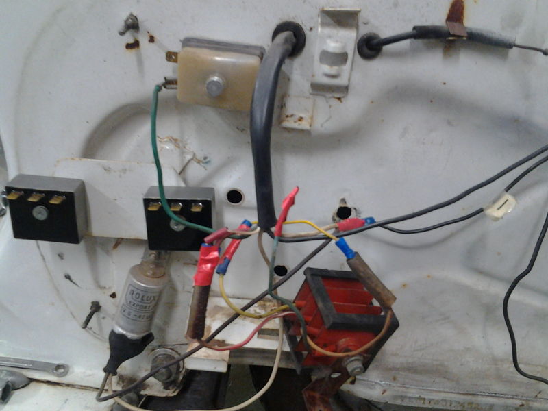

I finally fed up with this battery and these blinkers on my 74 Sprint 150V. Following the You Tube video from Scooter West. Mines alittle different . How many of you fellow MV ers have done this mod?
Battery gone add 6v regulators in place of the rectifier.
Wow, that's quite a gobbeldy-gook of wires. Two regulators? I feed the entire loom from one wire.

Good news it works perfect. Fired up fist kick lights are brighter than ever and the front blinkers come on bright but don't blink. They never even worked before. I can't believe I didn't do tis 6 years ago when I bought this thing. The horn is not working and never did but looks like I can get one that will.

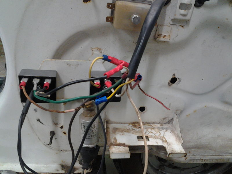

Oh the before and now after

can't see in pics...
grounding the reg to the frame is key
and the engine to the frame too
if this got done great if not you might want to do this asap
looks as if you grounded the regs to each other and to the center screw of each regs and then onto the harness or maybe the stator ground wire...??
adding on more black ground to the frame is easy
an engine that is only grounded by the gear cables / clutch cable =
⚠️ Last edited by spiderwebb on UTC; edited 1 time

and
- do put a grommet (or electrical tape) around those wires where they go threw the frame so they stay nice and un frayed.
- I think there is a lower voltage blinker relay you can fit that makes the blinkers work right = blink
the relay you have is either faulty or is is not getting enough power to allow it to operate like it should
this happens on battery bikes that have dead batteries:
1st the horn stops working
then the blinker turn on but don't blink
then the tail light goes out

The ground that you are speaking of goes from where to where?
@spiderwebb avatar
Posts: 629
@spiderwebb avatar
Posts: 629
the after market regs I have seen are 2 wire types
a yellow and a black
- those regs need to be grounded to the frame
- the stator is grounded via harness and its back plate at times
- a CDI if there is one has to be grounded to the engine (I also ground it to the frame)
the screw that holds the reg to the frame can be a grounding location but I like using a bolt in a different area that is sanded free of paint and perfect
if it is all working then don't worry
good job

Thanks for the heads up it works but you are right I need to clean things up and add another ground to each regulator I see that now on the video. Thanks for your help . I will post another picture after I finish.
