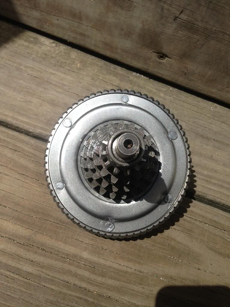

Does this rivet job look ok?
Thanks,
october

I'll be doing my first one shortly, so interested in comments.

Looks good for me. Be sure that the rivets are totally smashed and the plate has no clearance and it will have a long life.

Nice work! Were you on the bike when it failed?
No,
I was in there and noticed scoring on the front plate. The plate had become loose.

looks good to me

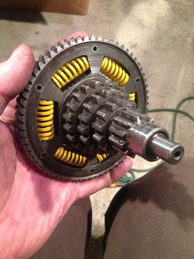

There is a good tutorial on the scootermercato site about rebuilding the cush drive under tech tips. The thing I did different was to grind off the heads of the rivets and drive them out with a squared off punch (since I don't have a drill press)

I made this video a while back, I didn't use a drill press either.

Mine has broken during a ride. It makes a terrible noise. When I oppened the engine the plate was completely smashed.

Good. Mine blew up like a grenade With me on it and it was awful. Dangerous too.
