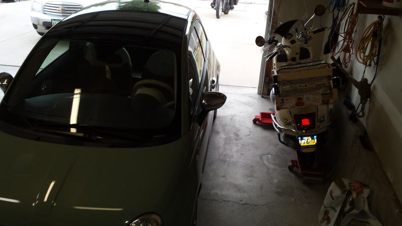

I found another good use for the side stand.
I bought this motorcycle dolly for my son's bike to make it easier to move in the garage but it doesn't fit his Vstar 650. The kickstand goes out past the spot designed for it. I will weld an extension on later. But I got to thinking that it might also work with my scooter. So I gave it a try today. I think its pretty cool! It is well planted on the dolly and I am not worried about it all. I think now I will get another one for him and modify it and keep this one for me.
The dolly is one of those harbor freight ones. With coupons and sales I was able to get it for $54.00. You have to use caution with Harbor Freight stuff but this seems OK. a few other people have posted info about these dolly's on the forum.
Scooter on dolly pushed into corner of the garage
Plenty of room to get the car in and walk past it too.
