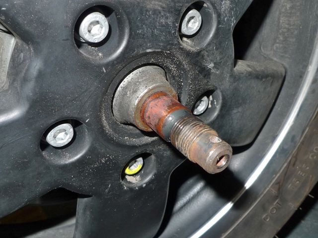

Can't get it off. It's stuck on the axle. I was prepared for that, but everything I tried failed. This is an 18 months old GTS 300 with what looks like the factory tyres. It has run about 12,000 km and has been parking in the street ever since January. The stub looks very clean. No sign of corrosion.
I have tried several penetrating fluids including WD40 and the best anti-corrosion (according to one mechanic). I've also tried to lever it off and almost torn one of these two-armed bearing pullers. (Cheap junk that looks like a tool, but is in fact nothing more than a toy.)
I have used a blow torch to heat up the axle. I have tightened the nut again. I tapped it lightly with a metal hammer and forcefully with a rubber hammer.
So now I have tried all the tricks that I know except ice spray and using a proper gear puller, which will destroy the bearing. Any idea what I can try before I let the dealer take care of it?
Posts: 45132
Posts: 45132
Find suitable bits of hard wood, and wedge them very, very firmly between the bracket and the wheel each side of the axle. Spin the nut back on the axle so it's flush with the end, to protect the threads.
Get someone to brace the scooter, and bang the end of the axle with a large dead-weight hammer. A not-too-forceful blow with a large sledgehammer will do in a pinch.
Wiggle, wedge, repeat. It will come off.
Don't worry about the bearing - any doubt as to its condition - replace. They are cheap, but may need lots of heat and a press to remove/replace.

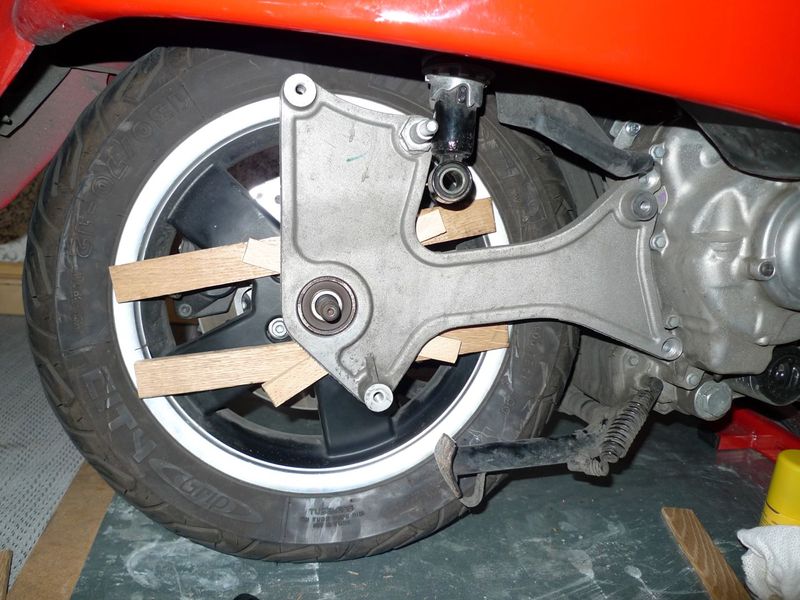

No luck so far. It doesn't move one bit, almost as if it were soldered onto the shaft. I bought another chemical. This one freezes the shaft.
I managed to put a ding into it.
I only have a 400g hammer and the plastic one has no dead weight.
Doesn't look too bad
Posts: 45132
Posts: 45132
You need to wedge it above and below the axle. Now's the time to consider the bearing will have to be replaced - get a blow-torch and heat up the bearing, then use freezer spray on the axle. Then *put the axle nut back on to protect the axle end* and swing a 2kg hammer at it.

I found some wedges and shortened the hard wood, so that it sits on the rim and not on the tyre. Put some real tension on it.
My blow torch makes more than 700°C, so I was afraid to put the flame directly onto the bearing. The gas tank is just too near. I've tried the freezing spray again and hammered onto the nut, but it still didin't come loose.
I give up, before I do more damage. I wonder which garage to go to now - the one that sold this Vespa to its first owner and didn't grease the bearing or the one where the mechanic said, he wouldn't give away all his secrets, when I begged him for advice.

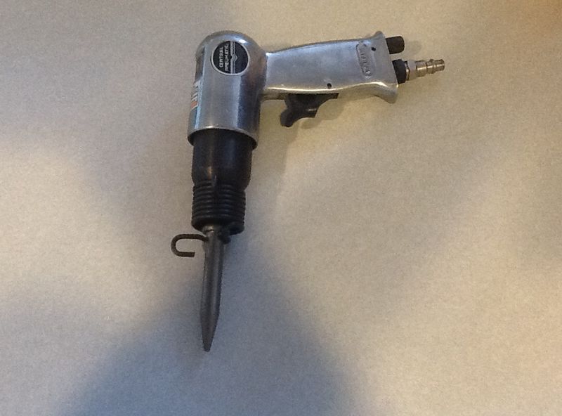

I use an air chisel with a pointed tip. Put outward pressure on wheel. Insert air chisel tip in axle hole. Make sure nut is protecting threads. Give it a few raps and "pop" goes the stuck bearing. No damage. Kind of works similar to loosing a frozen nut with an impact rattle gun.

The air chisel is a good idea, but I have no electricity in my garage. I have a 15l portable compressed air tank, which I fill at home. It's good for blowing away dirt, but not much else. Maybe it can drive the chisel for a few seconds.

Takes too long to ship. I haven't found an air chisel, yet, so I will probably order that. I have built my own puller and I'm going to give it a try tomorrow.

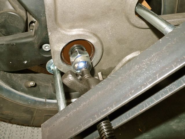

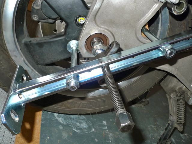

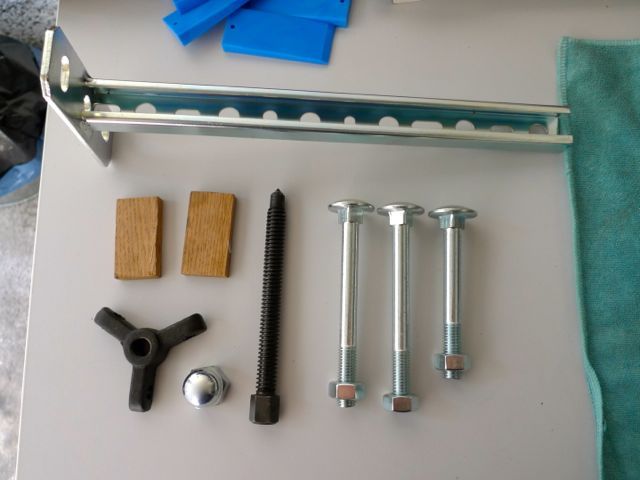

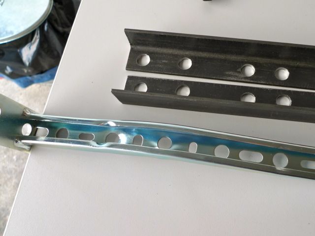

It is done
I found a T-shaped support for hanging pipes from the ceiling. I wanted something better, but this is all I found and the holes were the right size and at more or less the right distance. It was worth a try.
I re-used the yoke and spindle from the cheap gear puller and put a hat-nut (that's what we call them) on the axle.

Of course that didn't work. The steel was just too thin.
So I went and bought an L-shaped steel bar and drove to my parents' for some sawing and drilling.

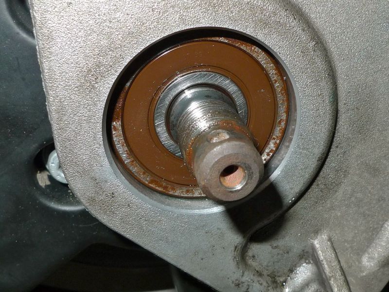

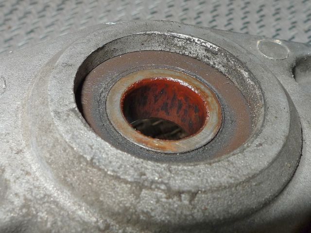

Turns out the corrosion was much heavier than I thought.
@der_blechfahrer avatar
Posts: 1922
Location: Berlin
Posts: 1922
Location: Berlin

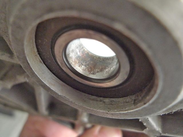

This is what it looks like after a bit of cleaning. The bearing actually works well, but the seat is corroded, so I better not use it again.
Do you think I have to replace the axle?
Posts: 45132
Posts: 45132
Well done!
I'd use a new bearing, even if the old one 'feels' fine. The axle is OK, just needs cleaning up - I'd use some wire wool. You won't be forgetting the anti-seize on reassembly.

Great job! Your tool is factory quality!
Bill
Posts: 1922
Location: Berlin
Posts: 1922
Location: Berlin
Premium quality from Piaggio

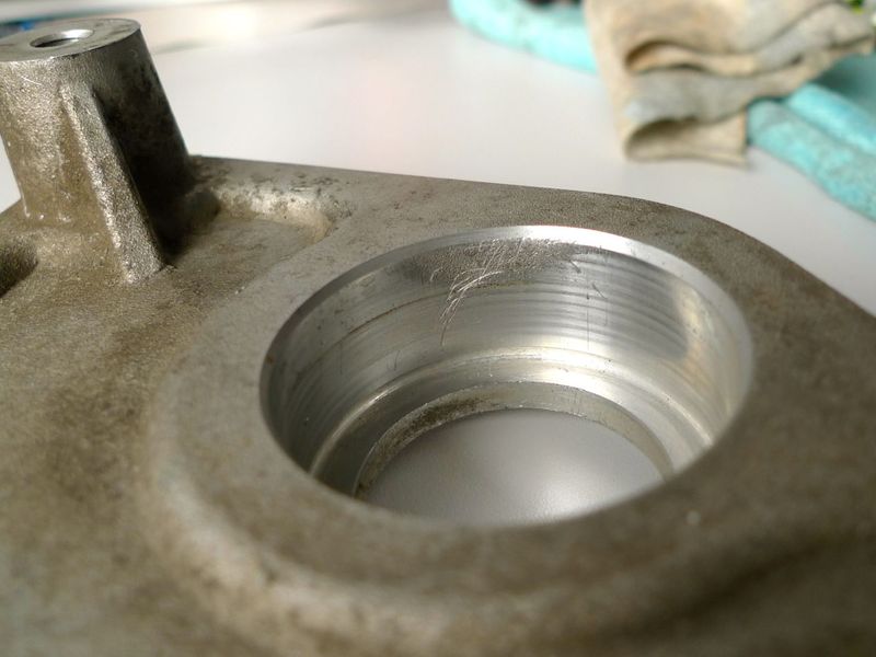

To wrap this up, my GTS is now equipped with Metzeler Feelfree Wintec tyres, which are fantastic compared to the old City Grips, which were very slippery. I can finally lean into corners.
I have also installed the Zelioni clutch bell. No more squealing and better control at slow speed.

I don't mean the corrosion. There is not enough material on the bearing seat. It works, but this is sub-standard IMO.
