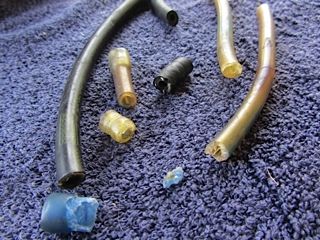

Mine looked fine. Here's what they looked like when we took them out. Just broke in pieces in my hand. I'm horrible about preventative stuff. I hate being stranded on the side of the road. This was done at 5yrs.
Where are these bits located?
Fuel lines. Check the line going to the fuel tap. To be fair the guys did mine but you should be able to see them around your carb etc. Clear one's the worst. The clamps in there are a one time use. We got ours at Lowes. The lines at O'Reillys.

I don't get why Piaggio uses that clear line for the vacuum operated fuel tap. That stuff is total crap. When you replace your lines, make sure you use proper black fuel hose. And use the black rubber vacuum lines too. It all lasts much longer than the clear tubing.
-Craig
MotorSport sells a tyghon(sp) one that lasts forever. So true Casch.People really need to change them. You can't tell how bad they are just by looking at them,either.
