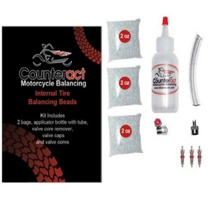

Anyone Using?
Your Comments Please...
I typically use my Marc Parnes Balancer, but wondering if there are any benefits to install this as well to make up for Tire Wear over the period of time the Tire is Mounted.
Thanks,
Keith

They are the same as Dyna Beads. Very small ceramic beads that do the same thing.
I have tried them. I have some (quite a lot actually) if you're interested. I never found them to be beneficial.
IMHO they are akin to snake oil.

I wouldn't say complete snake oil but I do agree that they are no replacement for a properly balanced wheel. However, as tires wear the balance point can be moved and beads could help offset this when at speed as that is the only time they have an effect.
Are they worth it for that? Not for me but YMMV.

Hi,
I am actually very positive about Dynabeads - yours look like the same concept.
I have just got new front tires installed (have not planned that but it is a different story) and service man claimed that this kind of wheel do not require balancing.
Very shortly on the highway I found that is not true and above 100-105 km/h I could feel growing vibrations. Ride above 110kmh was impossible.
After applying to all wheels (yes, why not:)) the right amount of 2oz to each and getting back on highway again it is different ride - there is a brief moment you can feel some but after reaching crusing speed it goes dead smooth.
Application was quite easy - used funnel attached to piece of rubber pipe and screw driver to tap on it quickly - took me 15 minutes including inflating. Price was OK even with shipping from UK (I live in Denmark).
Can recommend this very much.

What's supposed to make these different is they are Teflon Coated and they stick with static charge to the tire, vs just falling to the bottom when you come to a stop.
Anyway, I still like the stick on weights, but I can see adding this also for some possible extension of tire life, and elimination of Vibration.
A friend of mine mounted a GoPro Camera on his bike, and did a before and after Video, and you could tell the difference with his recorded Video where there was no image stabilization required on the After Video. It was very smooth vs the one without the Beads, you could see the shaking in the Video.

This is the dynabead demo video. It would seem that in order for a bead to actually work as professed they should not stick.

Sticky, CounterAct use's a little different design with the Teflon Coating which causes a "Static Electricity" to hold them in place for a short period of time, so it does not have to re-balance the tire at every stop like the Dyna-beads do? I seen this video, there are some on Youtube that show how the CounterAct work where they stick to the side of the bottle.

Beads work. BUUTT-- you have to match the amount of beads installed to the size of the tire. Had mine in for about 5000 miles and smooth as silk. There is a chart. Check it out!!

I suspect that those who have had poor experiences with beads had wheels that were too far out of balance. If you put two ounces of beads in a tire/wheel that's more than two ounces off, the beads can't possibly make up the difference. But if the wheel nearly balanced with weights, the beads should make it perfect.
Of course with a one-lunger, there is no complete freedom from vibration.

a nearly balanced wheel is not balanced.
Using beads does not make a tire balanced in all situations and speeds.
I have yet to see a tire manufacture or a vehicle manufacture use or endorse beads. Also have yet to see ANY type of motorsport racing team use them.
A properly balanced wheel/tire is balanced in all situations and speeds
