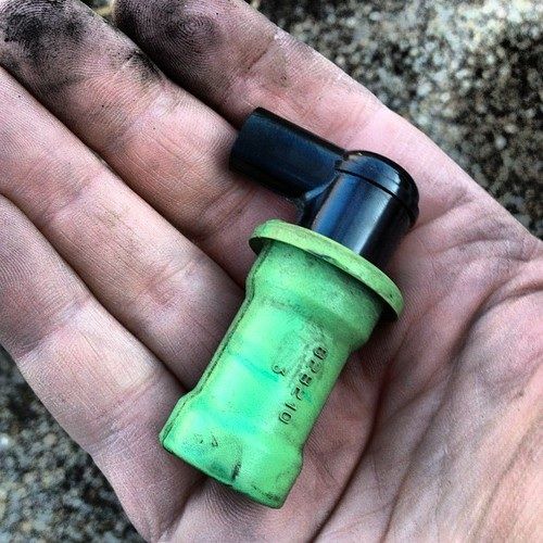

Quick question. Yesterday my spark plug wire came off of my 2007 GTS 250 and was then pretty much destroyed upon trying to reattach it. (Don't ask) Ordered a new one from Scooterwest but in the process of pulling everything out I noticed the green spark plug cap is not there. I just changed the spark plug out in April and I know for a fact that green cap wasn't on there then either. Question is, do I absolutely need that green cap?

I've come to the conclusion that Vespa engineers want to see us suffer when working on these things.
Posts: 45144
Posts: 45144
The green bit is to prevent you breaking the black bit when taking the cap off. A 19mm open-ended spanner is to be used as a lever against the lip.

Thanks Jim. It's cheap enough I'll just order a replacement.

The guy at Scooterwest told it was a high performance wire and cap. But it is exactly the same length as the Skok one. Could have given an inch or two more for working room.
Let's see if anyone finds the missing Skok.
