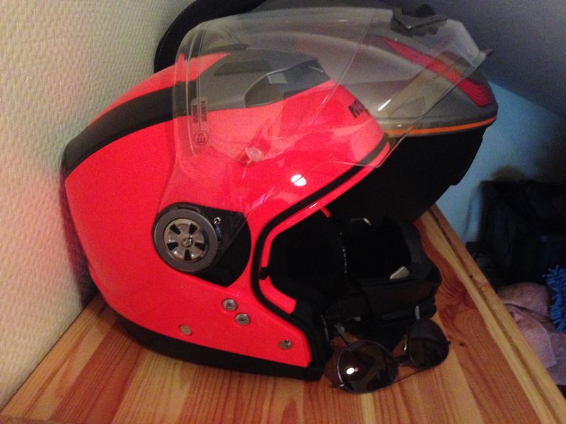

Wind and weather...
McKee here some pics.
Some with the top screen up, some down.
Hope it will help you.
André
My helmet, super happy
