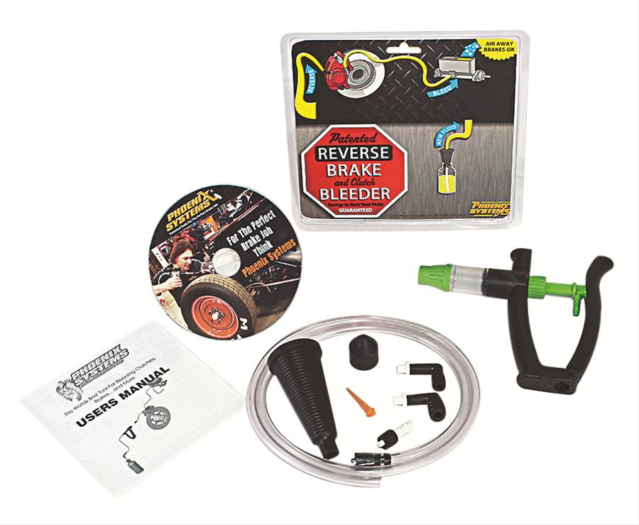

I was using this which is just a fancy syringe. Next time I will try just a plain old syringe. 100cc ?

That doesn't look big enough to hold all the fluid needed for a brake bleed. It has to hold enough fluid you can push it through in one shot.

Yeah I think I wasted money on it. The idea is that it is a continuous feed from the bottle to the syringe to the brake line and it does do that but it is rather fiddly to use.
