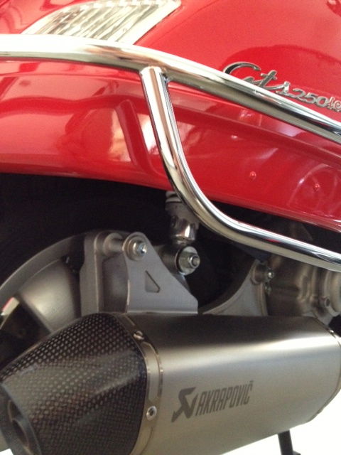

Just about to fit a akrapovic to my GTS 300 and noticed in another thread that the genuine Vespa crash bars can't be fitted when using the akrapovic.
Are there any make of crash bars that do work with the akrapovic exhaust, some crash protection is better than nothing in my eyes

Here's my GTS-250 with Piaggio crash bars and Akrapovic exhaust. Both fit as if they were made for one another.

Same set up as mine-Works a treat!

I never plan to crash but better to be safe than sorry, plus I do like the chrome .
This is the thread I found where the crashbars damaged the exhaust-
Akrapovic carbon fiber melting
Also PM Tuning state on there website "please note this exhaust system is not compatible with the Vespa original chrome kit or rear side protection"
I would be so gutted if I damaged the new exhaust as anyone would be.

Hi, I did mine - hit a bump and the sidebar crushed the cap of the Akrapovic. I raised the shocks and made up a bracket to lower the muffler, I think I'll probably remove the side bars as I like the akrapovic too much
Just realised, I had Faco sidebars not the Vespa ones (so maybe you'll be fine)

I had the side crash bars and the Akropovic exhaust on the bike for about a year together. Never had any problems whatsoever.
I am also 300+ lbs and ride with my 140 lb gf from time to time. So we were throwing over 450lbs at the set up and never touched once.
I also did this with stock shocks, and malossi shocks, but both sets of shocks I had the pre-load maxed out, so that may be a factor.

Thanks for the photos sharing, it is obvious that Akra fits perfectly with crash bars, however, for some reason, even on SIP webshop they claim that Akra (and Remus btw ) does not compatible with any type of side crash bars, what the heck??

Thanks for the feedback and looks good to go, I am also not sure why the websites say not compatible when clearly it is.

That reference is for the older version made by logo scooter, the new bars work no problem.

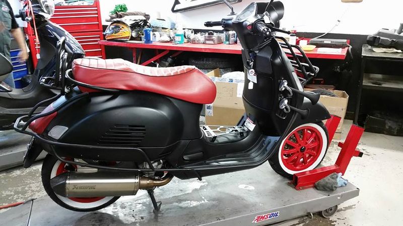

interesting.. that akra muffler looks EXACTLY the same as the Malossi muffler for my BV350.. has the carbon fiber end cap self-destructed yet? I'm just curious as i'm still looking for a replacement.

here is mine with the Malossi RX that is pretty much identical to the Akrapovic[URL=http://s98.photobucket.com/user/angryrican66/media/Mobile%20Uploads/6538C083-B2AE-4E98-A5E0-18509B14238F_zpsot5o1tlv.jpg.html]External inline image provided by member with no explanatory text[/URL]

^ thanks for that.
Malossi told me a new CF endcap cost $100 + shipping from Italy and I'm just like.. *middle finger*
how's your muffler's rear end holding up?

so far so good. The Akrapovic end cap cost about the same ( I cracked one on my last GTS)
