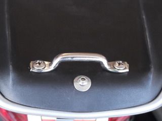

#2 Tie down point. A footman loop.
This is a "footman loop" or strap bracket. Costs around $10 bucks at a jeep or kayak store; a buck at the tractor supply. Add about $5 in stainless fasteners and you are still under $10. A loop strap and 2 RockStraps holds the duffle in place and is perfect for an old VenturaRack sport bag. I drilled out the torx screw and used an M4 button head bolt. Cuz if it was going to fail it would have been out in the middle of nowhere or on a tall bridge. No more duffle.
