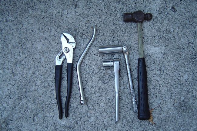

These are the tools I used. I have a break spring tool that was great for removing the spring, but it's useless for putting it on. You have to hook up the spring before installing the bolt.

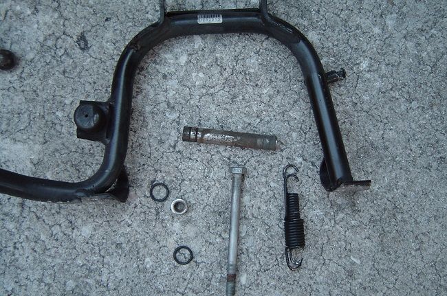

These are the parts. I had to use the breaker bar handle to remove the bushing. It was the size I needed to use as a punch.

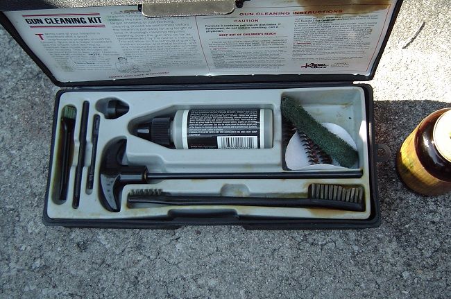

I used my gun cleaning kit to clean out the hole the bushing fit's into. My 40 cal. brush was small but it did the job. A shotgun brush or a bottle brush should do a better job. The cleaning pads worked nicely.

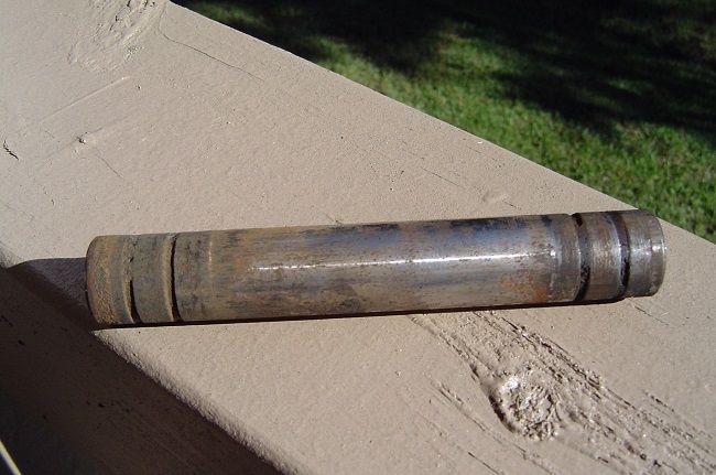

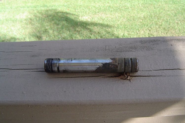

This is the bushing after less than a year. I know that someone drilled the bolt and installed a grease fitting. I'm not going to because this was not that hard and I feel that just squirting grease in isn't as proactive and excess grease collects grit.

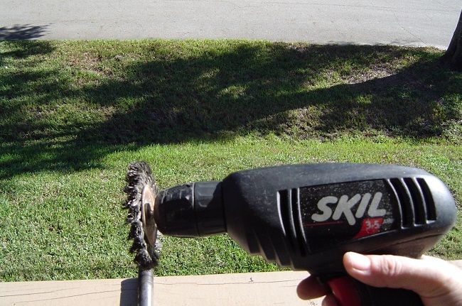

This is how I cleaned the bushing. It would have been easer at work but I wanted to get done today.

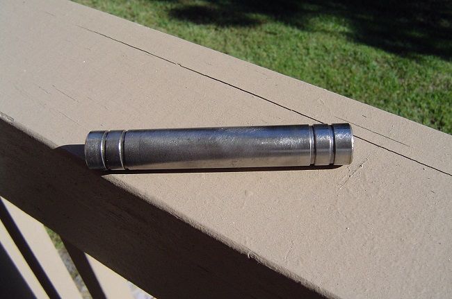

This is the clean bushing. After I lubed it up and the hole it fits into, it slid right in. I used some marine grease because I have a boat and the stand gets wet when I ride in the rain.

howdy, I had the tabs that the pin goes through break on mine and found the factory welds not to be welds but only tacks. so check those welds where the tabs connect on the round stock. on mine the tacks were on each side but there was no continuous weld. it did break so there is a factory problem on that center stand

the tabs i'm talking about are in your picture two and are the ones going north out of sight
ken
edit, that was on my bv350 and that looks suspiciously like not the same center stand so either they changed them or that is not the stand from a bv350
