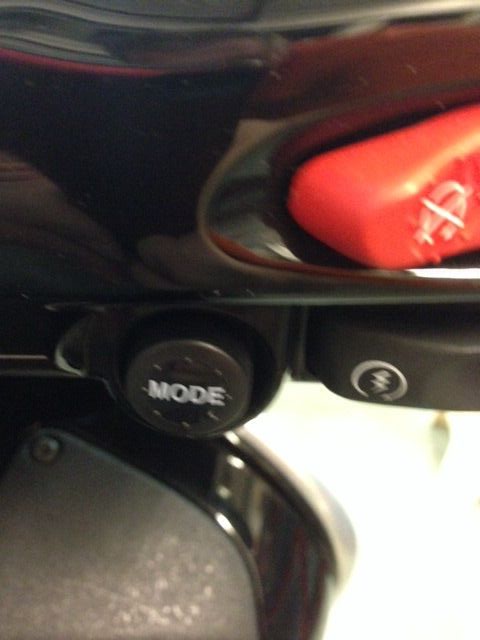

Dooooh. Which is the mode button please

This
