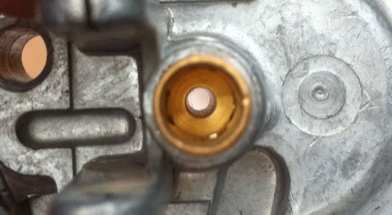

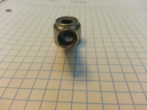

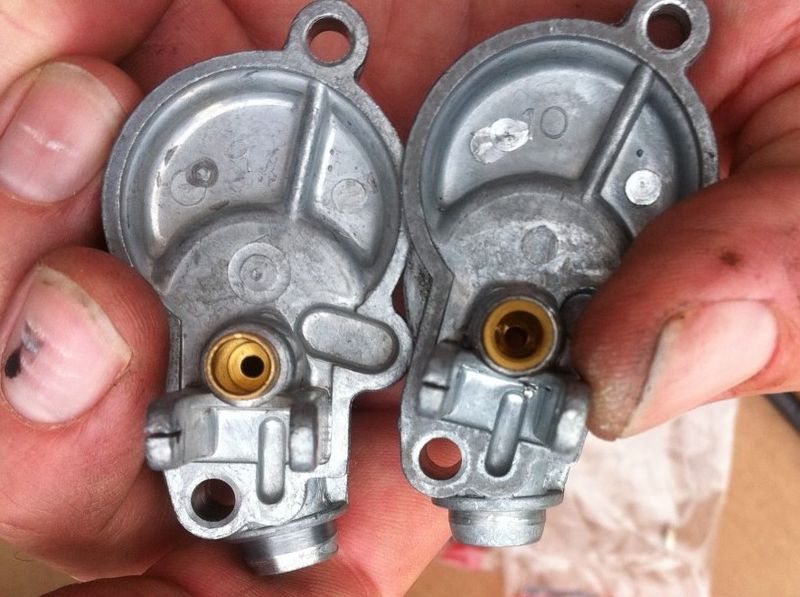

Si carb mods...
My px float chamber needle was leaking badly so I bought
the cosa float chamber with the 5.2mm needle and did some mods...
With some careful mods it will be even better than the expensive
DRT or Pinasco float chambers:

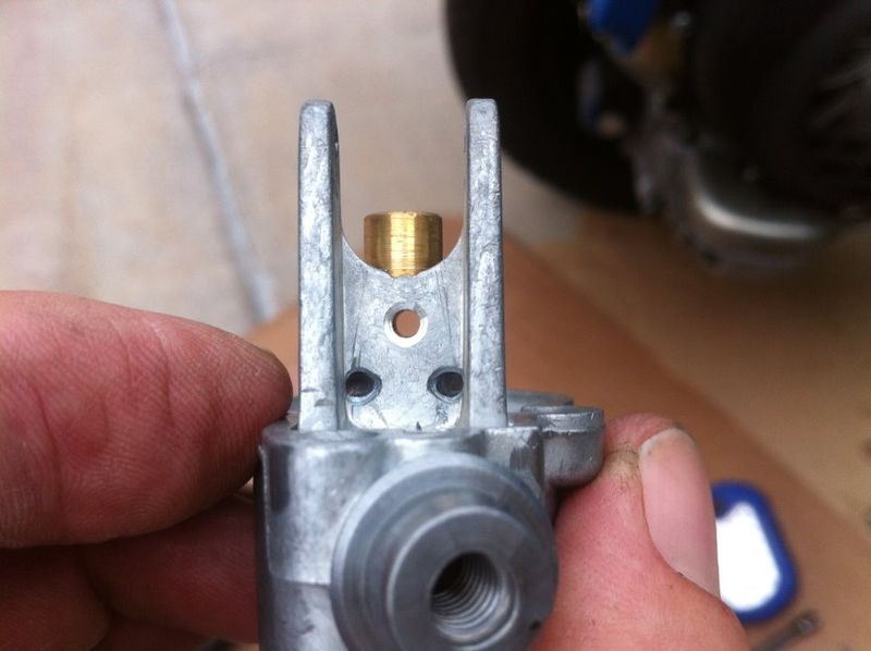

5mm hole fuel line into float chamber>
Bigger holes to the needle + 2 more>
Most important hole: float chamber to HD 2 - 2.5mm>

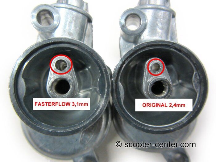

Good thing about the Cosa float chamber is that you can drill
even the needle seat bigger (the px and cosa are 2.1mm), I
drilled it to 2.35mm and 3.1mm down just 4mm before the
needle seat>

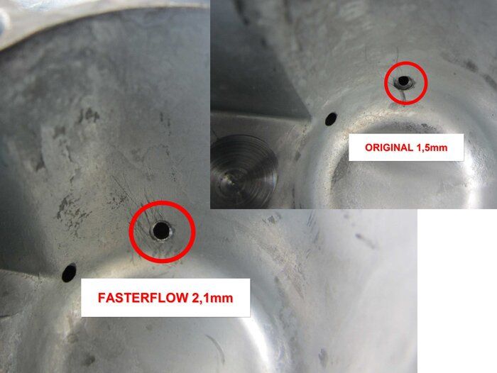

Actually you need only this hole... 1.8mm for 166 and 2,0mm for 210!
I needed every flow, because I run a malossi 210 with expansion chamber and Si24... now it goes 46 mph GPS in 2nd gear (8250 RPM)...

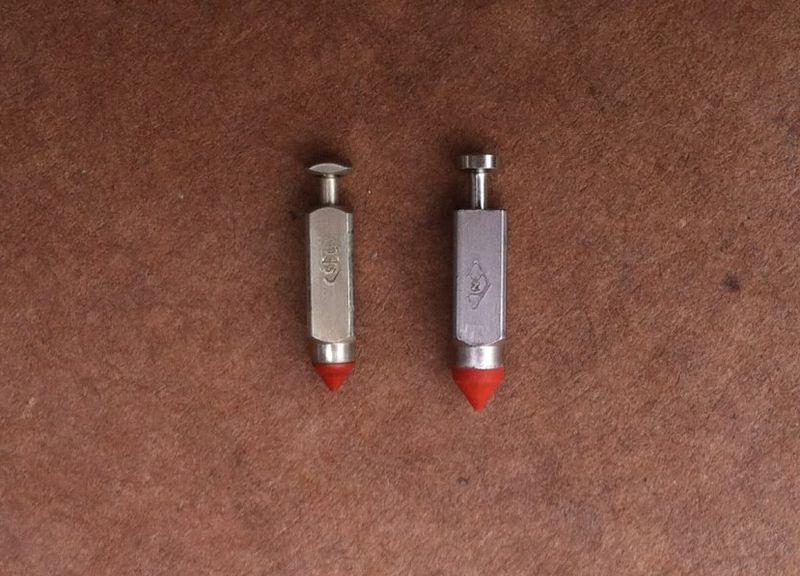

I think the bigger needle was standard in the european Vespa COSA models. This needle alone will not fit a PX float chamber. The Vespa T5 with the SI24G Carburettor had the bigger needle/needle seat in the float chamber.

Yes, because this is the most important hole. But be careful not to drill to deep, measure it beforehand. I think it was 12mm deep. You have to drill with a longer drill or a dremel to access this channel.
2nd important would be to widen the 2 holes in the needle seat...

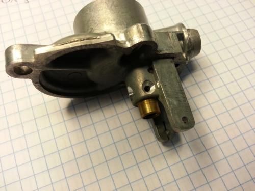

I've re-read the above post. I'm convinced I'm suffering from fuel starvation. I am thinking of buying a cosa float bowl and hope to drill the right holes. I don't want to touch my original T5 float bowl. I will also get a 5.2 float needle.
How many holes do I need to drill and where. I'm not exactly sure from the diagrams above
Absolutely.
Are you sure about that? I have 5 Dellorto and 1 Spaco carbs for T5, and they all have the regular PX float chamber with springless 4.5 float needle. From what I've noticed, the only actual difference between an SI24/24G and an E (T5 vs PX200) is the difference in height (10 mm).

There's something odd going on with the above video. It looks to me that the Cosa needle (which is slightly taller than the un-sprung P needle) is blocking the flow out the side holes.
