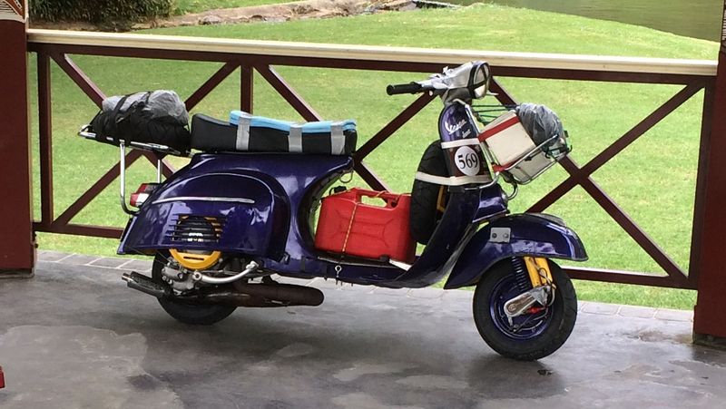

Now there's a scoot done up right for a long haul, looks the part for sure and sounds like the mechanicals are in perfect order or soon will be. I especially like your be-kind-to-my-ass seat mods and trendy safety taped headlite.
@subetherbass avatar
Posts: 5108
Location: Australa, Mate
Posts: 5108
That pic was while on the VIC Mille, riding with my awesome friend Ginchi (as we like riding together whenever we can) hat was a temp seat (I picked it up from Sam Mai in Bangkok - if anyone goes there, I can recommend him & put you in contact... He got the LML/Vespa shop to open on a Sunday specially for me! It's now with Ginchi), now it's got my luxurious (& damn expensive) king & queen seat back on it.... There are some pics on following post... Yeah LOTS of pics, as its designed to 'look' different from every angle... Ohh, & cost somewhere in the 4-figure range to get the precision ulpholstery done (I only found 2 places willing to try it!)

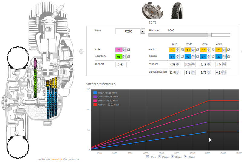

More thoughts behind my GEARBOX choices
as you would have read, I spent a LOT of time working out gearing for my VBC & think I've created the ideal "open road" gearing for what I am trying to acheive, but working within a budget. primary was goin to be replaced no matter what, & I started by working out which to use by looking at speed/revs/torque that was needed for
1st was also retained, & not much use around the city, as it's slow slow slow off the line, but kicks in at (I guess) 15km/h only, but goes till 35-50km/h.
2nd was made much longer (ie replaced), so it was close to 3rd, so scoot would stay on the pipe
3rd, was what I worked on the most to ensure it was fast (I wanted to do 90-100km/h in 3rd) & on the pipe PLUS had good torque for hills, there as soon as it came out of 2nd it needed to GO GO GO.
PLUS, as I had a budget (it was about $1300aud for my "ideal" setup, but blowing that much on a gearbox alone meant other components had to be compromised) this ALL had to be achieved using the ORIGINAL 3rd.
4th, well this was the fun one...
A: knowing a LONG 4th is pointless due to never being able to get on the pipe,
B: long 4th = having no torque, there are pts of hills where I ride
C: speed limit here is 100km/h so going 130+ will just cost me more speeding fines , so 110-115km/h was the designed top speed (so far 118km/h is "normal top, with 124km being the "downhill tailwind top")
D: 8" wheels!
E: scoot/gearbox was not designed for city riding
F: Removing 1 tooth (ie T5 4th) was never a consideration....
G: knew I had to buy a 4th no matter what option I took meant $$ was not a concern...
there had to be a better option...
So I played & played with the calculator, & decided knocking a few teeth off 4th was the best solution
Now Speedy has a full custom close ratio box!
There may be a bit of helpful info in this thread
modify VBC1. 2-port -got fuel, need tim(ing)? Only 67mph
NOTE: I'm working with 8" wheels.
Most here will recommend the "T5 4th", which is merely 1 tooth less... But that's coz they are following the crowd & basically Unimaginative, or don't have a long primary.
My recommendation is to knock 2 or 3 teeth off 4th... Make 3rd & 4th as close as possible, then it's always on the pipe & pulls. Up hills whenever the revs drop, I simply bung it into 3rd, & it's off again
AnaKey runs 10" with a long primary, but like yours, can't get on the pipe in 4th unless downhill with tailwind... But bugger me, when it does it's a beast! Top GPS speed: 140km/h!
I wrote this elsewhere, but think it also needed to be here

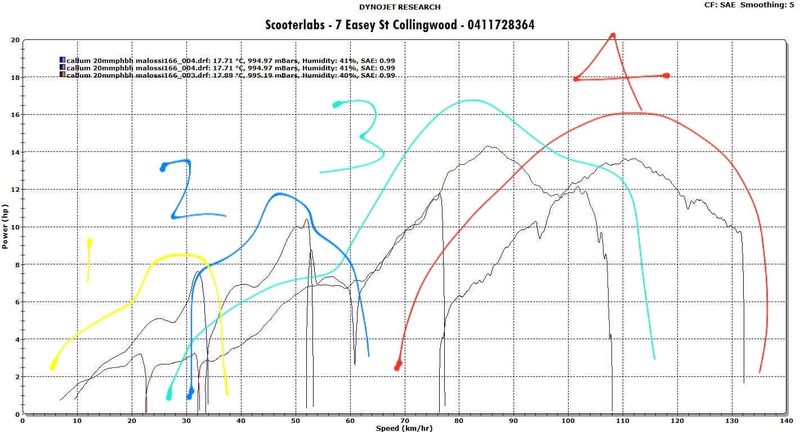

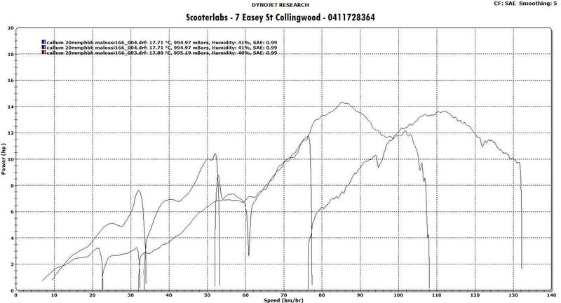

DYNO day
After about 3yrs in the planning (well, waiting till motor actually worked!)
The proof is in the pudding... Next Wednesday is DYNO DAY.

SubEtherBASS wrote:
here is the FINAL gearing
GPS said top was 117km/hr on first day, & it was quicker on day 2... Or so the GPS told me as it seized...
Hardest bit was remembering if i was in 3rd or 4th... 1200rpm rev drop between gears sure ensures the power stays on!
Im stoked at the final gearing setup... But for higher speed it would be tempting to get a longer primary.... But for twisties going 2-3-4 while under full power was simply awesome... Damn impressive!
In the end the gears (& budget) stayed as they were... Now many miles later I'm happy...
Re: Final set-up (or what I can remember of it)
This is the final Gearing:
Primary Drive: 24/63 Malossi (as they were the only ones that did it!)
PX xmas, with following: 12/57 (12.4), 13/40 (8.1), 17/37 (5.73), 21/37 (4.63)
1st is standard, 2nd is exceptionally long, 3rd is standard, 4th is exceptionally short
Well... Now it's official & may the dyno results back it all up...

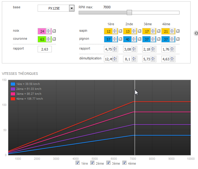

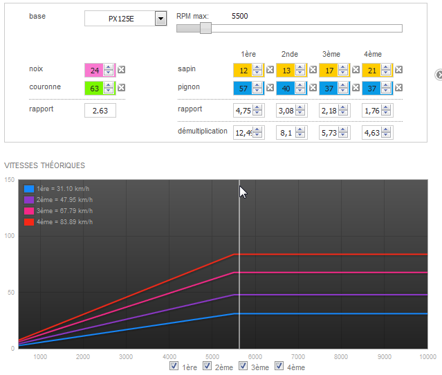

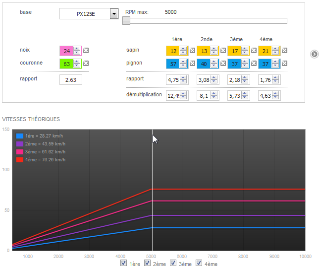

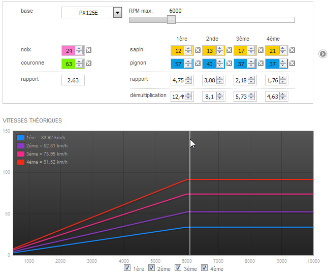

Re: Reality in Chart Form
SubEtherBASS wrote:
I played with the calculator again... & here are the results:
This is the gearing that is CURRENTLY being used...
Calculated PRIOR to Dyno... On 8" wheels
They were originally noted somewhere back in this thread
5000rpm
5000rpm
5500rpm
5500rpm
6000rpm
6000rpm
7000rpm
7000rpm
⚠️ Last edited by SubEtherBASS on UTC; edited 3 times

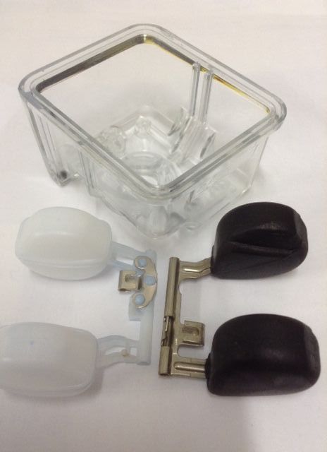

Re: They arrived
SubEtherBASS wrote:
YAY, the new floats arrived, plus a clear bowl, so it will be easy to see whats happening inside & where the fuel level sits.
now to fit it over the weekend & go for a ride. Def will start with the HEAVY one, as it simply makes more sense in my eyes.
Was having a HUGE issue with "running out of fuel" cutting out at the bottom of every hill... Then it cleared 300m later! It has caused 1x seize while kaning it after a petrol stil, on a hill!
Both Polini clear carb bowls have discoloured, to match the oil I was using at the time.
Both have now warped to the point of large leaks, & it's obvious to look at.
One day I will (when partner is away) put them in the oven & soften them up, put a waitstaff on them & see what happens.
Had to change back to original black bowls...
Spotted the height differed, about 1 to 2mm (measured by a qualified eye, then completely forgot results" eye) .. Put on deeper black bowl...
Problem goes away, gofig!
⚠️ Last edited by SubEtherBASS on UTC; edited 1 time

Gears are more awesome Than I remember.
Minor bits to do only

Re: the 3 R's... Revs, Resistance, Reality
SubEtherBASS wrote:
SubEtherBASS wrote:
SubEtherBASS wrote:
Option "B"
Primary: 24/63
1st: 12/55
2nd: 13/40
3rd: 17/37
4th: 21/37
The speeds vs revs are as follows...
Revs: 5000...6000...6500...7000...7500...8000...8500.
1st:....29......35......38......41.......44.......47.......50
2nd:...44......52......57......61.......65.......70.......74
3rd:...62......74.......80......86......92.......99.......105
4th:...76......92.......99......107.....114.....122.....130km/h
Rev drop between gears (otherwise known as: will it stay on the pipe?")
1-2= 2500-2800rpm drop
2-3= 2500rpm drop
3-4= 1500rpm drop
So, after a good lengthy ride this past weekend, fully loaded & mostly as a cruisy pace (leader was goin 85kmh on GPS)... These are the results...
Revs: the revs were down a bit, but i guessed that as still need to book a dyno, & rebuilt carb (fuel was pouring out) night before rally, then there was an airleak (revs would stay high between gears, & after 20-30 sec at lights the revs would go up), so it was a sedate (for me) ride... Potential revs vs actual revs do differ,& in reality its always goin to be lower.
Resistance: wind, hills, other riders, riding a brick, rider & luggage weight, friction, scoot components age & numerous other factors cause resistance... Which in reality is more than you expect.
Reality: while a calculator is a great thing, its a rough guide only, & even physics change the outcome.
These are my REAL results (as much as i could remember & write down while riding...
There is a nice rev range, just below the powerband, which if you sit there, its easy (from those revs) to accelerate, get up a hill, pass someone,or simply take-off into the distance ... However its easy to sit & cruise at this speed/rev all day & watch the scenery.
Above that there is the powerband, where fun is to be had & egos enlarged... However its only for shorter periods & generally for accelerating quickly, going up hills , pass etc, but unlikely the motor will last 100's of constant kms at this range.
Then there is MAX speed/revs, the bit you use on real steep bits, or where you want to be right in the powerband (if your gears are spaced too far apart), or when you need to extract every possible rev to hang on the lower gear till after the guy on the harley changes first & loses momentum, which is short-term thing & will make your motor explode/fail/cook real quickly!
... So what was the REALITY of Speedys setup?
125 & 122 relate to differences due to a jet change.
Top rev appears to be 7000-7500rpm (likely more, but counteracted by additional weight).
3rd will rev more than 4th as there is less load & motor has better ratios vs resistances, i guess this is why dyno results are done in 3rd gear.
... So what is to be learnt?
When calculating gearing & Revs (using aforementioned calculator), use 4500-6000 as your cruising range, 6000-7000 as your powerband, & 7000-7500 as top revs... Then you will be in a realistic reality.
Yeah, it will be quicker without so much luggage, & after a damn good tune, but thats a bonus!
Perfection was 84kmh in 4th, it seemed to keep going back to that speed on its own, then goe all antsy trying to bolt!
These seem pretty accurate... Hmmm... More revs than I thought

Here it is... The OFFICIAL DYNO RESULTS
Here is how I see it...
Grunt;
Highest = 14.4 hp
Amount in "usable rev range" = 10 hp
& the all important... SPEED !
1st = 34km/h (defo not full throttle)
2nd = 61 km/h (ditto)
3rd = 32 km/h to 108 km/h (fuk yeah!)
4th = about 45 km/h to 132 km/h (OMG that sounds fun, yet mildly scary)
Not bad for a wee 2-port VBC 150 motor!
Note: 1st & 2nd didn't get seperate runs, as only 3rd & 4th are checked... Ohh well.
I'm amazed that the calcs worked, it just appears to be revving about 8500 rpm, but I only calculated 7000rpm.
As you may see... In 4th I was watching the Dyno speed & saw.. 120, 125, 128... Revs getting higher... Then thought: Ohh well may as well see if it will go 130... Yip, damn that's really revving now... Button off time, I've got about 3000km to ride in a few days... That's enough.
Result: 132 km/h & STILL pushing 10 hp ! YEEHAA !
[/u]
On paper.
On paper.
@ginch avatar
Posts: 10333
@ginch avatar
Posts: 10333
Now you need to check your timing at those peak revs and see that it's within spec... we need to do something about the crazy overheating.
Do you know what revs it is doing at the peak?
Yip, the heat issue sure needs to. E sorted.
Sadly ScooterLab's machine has no rev counter

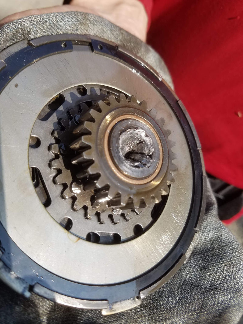

Well n truly buggered the crank!
On Xmas day went for a ride with Il Ginchi & got a flat tyre, which caused Speedy to "fall over" (as speed), & for the rest of the ride the clutch was "rough", and hard to change UP thru gears, but, so what, I knew the plates were worn, so didn't care too much & continued.
Then, A few days ago I Went out for a ride on Speedy along Grand Ridge Rd with Il Ginchi... clutch was still the same, and adjustment did nothing, but riding without a clutch is something I'm very capable of doing, so ignored it, except it "slipped" a few times. Then it stopped (sounded like it ran out of fuel, or timing was out... as we were on a wonderful rough gravel road, jet was unblocked, & flywheel was (forcibly) removed (once jammed key was dislodged), it looked like it was not sitting "quite right", so sanded a bit & put back on ... riding along & lost drive yet again... so out came the spare plates (I always carry!) & off with the clutch cover... which had a bit of grey mulched metal under the cover (nothing unusual there!)
Well... then out came the clutch basket... grabbing it & having a look I realised I hadn't actually undone the nut yet!
Yip, out it came!
It had SNAPPED off the crankshaft! Which had a cool rounded, pointy end!
That was it for the days ride!
An hour ride asillion on the Green Ginch Mobile (where i may or may not have taken a nap) back to the van, then a return trip to pick up Speedy from deep in the bushes on the side pf the track we went!
I guess that's the end of that motor, till i can afford another VBC1 Crankshaft.
Yip, out it came!
Info on the Recent Flywheel changes; Changing flywheel size... SUCCESS is COOLNESS!
Well it really sucks that you're down but on another note I don't think its too late for beginning a narrator. Totally enjoyed the play by play. 8)

At least the DRT Clutch is still ok!
Well, heres a pic... i put it back in the motor to ensure I didn't lose bits in the grass, so once i remove it again ill get better pics.

Wow. That was some lucky break. Need a new crank but the clutch escaped without a scratch.
Was that crank a 60mm? If not speedy could be speedier.

Nothing there a little JBWeld won't fix! Razz emoticon
Worb modified, Mazza full race from memory, I dislike long cranks due to extra distance travel of piston moving causing higher temp/speed of piston in barrel, plus options for VBC1 (small flywheel taper) cranks is limited.
