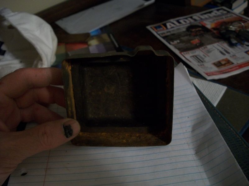

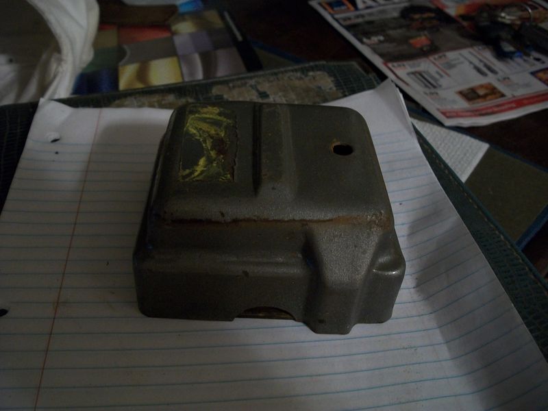

$6.40. Also, I think it may help if you had the factory battery top? It is a metal cap that fits over the top of the battery. This one is from my Rally, but I am no longer running a battery. Piccy-

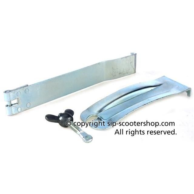

the Rally/GS 160/SS with the tall square battery use a two piece metal setup, and you're missing the top piece.
this is the setup you need. it's from Pascoli, witch is Italian for 'expensive'. $35, but worth considering.
http://www.hodgespeed.com/23077400/dp/24710
this is what it looks like.

My mistake, but it looks like the strap Rob posted a picture of would work with the cap I have. Auto, if you are needing this cap, it's yours for the price of the ride.

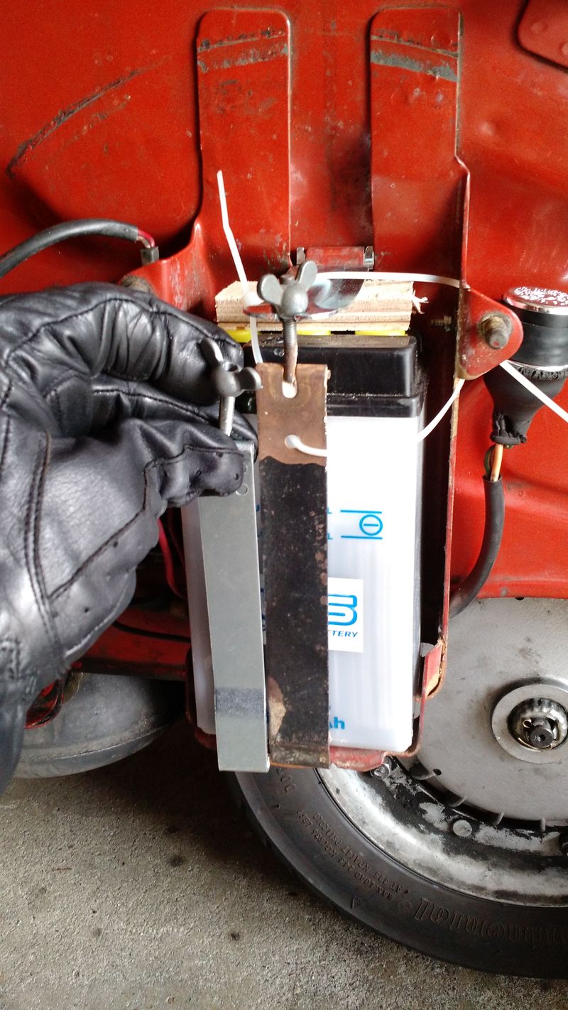

Update: got the strap from Rob, the vertical piece it came with is too short for my battery by a couple of inches, but the horizontal piece is correct. The battery cap I got from Tierney is just a little too small for the (brand new) battery I have now. I ended up making the old and new strap parts work together by putting a wood shim on top of the battery. No problem until I was riding today and heard a clank. I trusted my instincts and stopped to check things. The strap bits had fallen off
Luckily I just walked back and found them in the road, and I was close to home so I went back and attached them again, but I'm not convinced they won't just fall off again.
Anyone have any other clever tips for this, or does everyone else just not run a battery (or still have all their original pieces)?

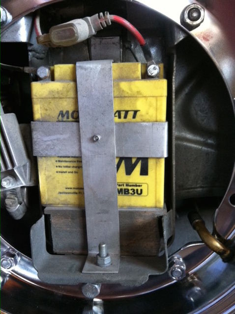

An option worth considering is converting to 12V and/or fabricating your own bracket. That's what I did, using aluminum stock from the hardware store.

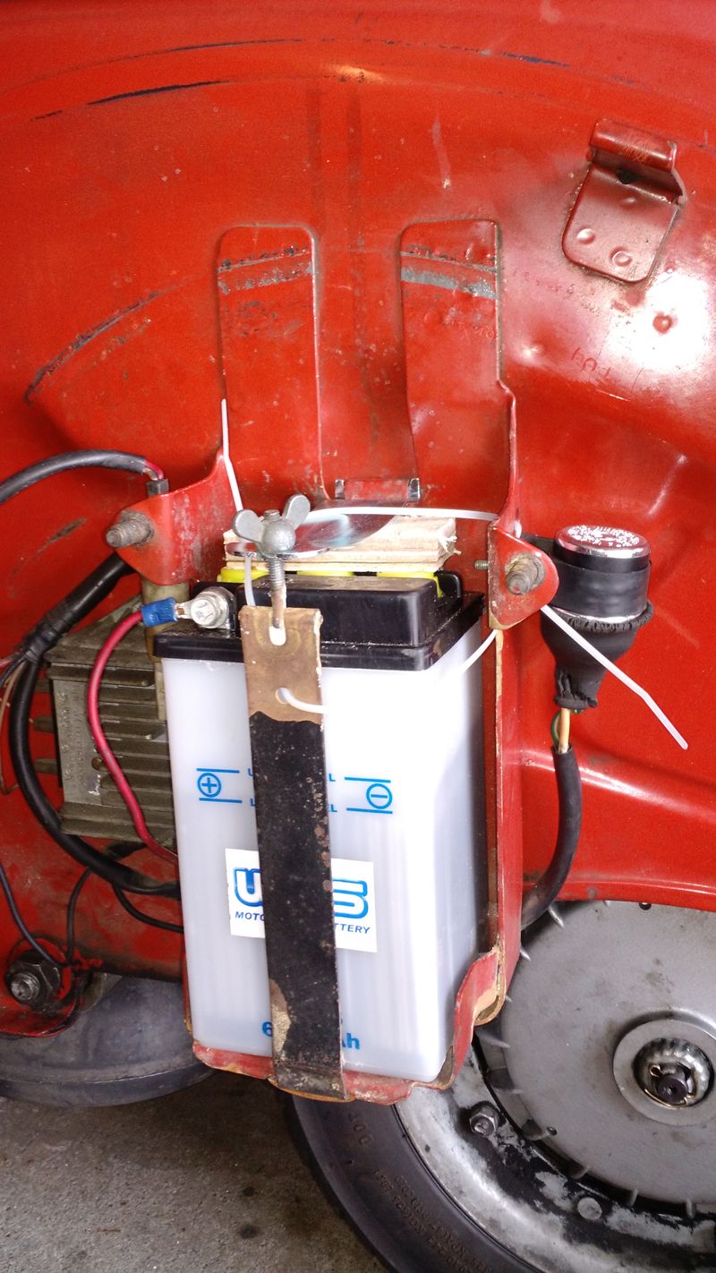

can you shoot me a picture of how you have it installed?
Nice work!

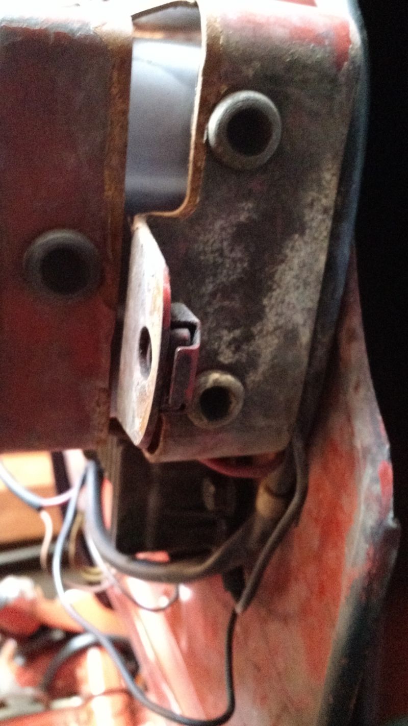

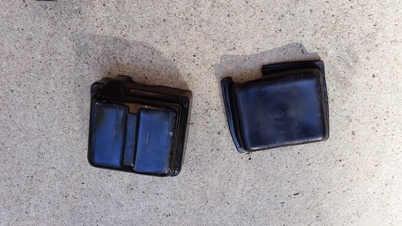

Yep. One shows the new strap which is too short. I added the zip tie so at least if this pops off again I won't lose the vertical piece.

There should be rubber spacers beneath your battery. It would be tall enough then.
They look like this:
http://scootersoriginali.com/collections/vespa-rubber/products/vespa-buffer-battery-tray-large
You need three of them.

yes, you need to remove the wood and install the rubber buffers the battery sits on. without those, there's no 'give' to tension the strap against.

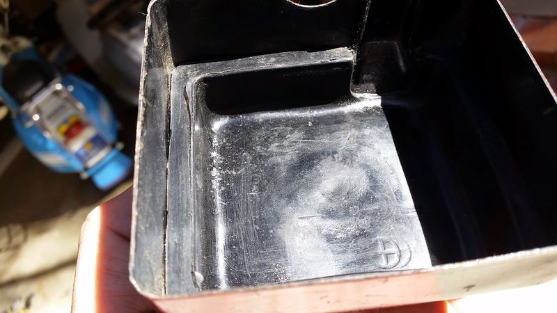

I have the buffers. They're hard to see in my other pictures. Here's a shot of the underside of my battery tray. They're about 1/4" thick under the battery. The battery is about 6.5" tall. Maybe others are taller?
