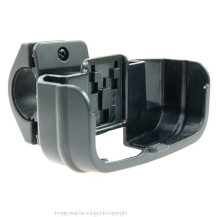

Something like this may work too. The holes in the top part of the clamp might line up with the holes that are already there.
http://amzn.com/B004X69OR2

I use the RAM "Large Suction Cup", with the small adapter to the Garmin Nuvi / Zumo that looks similar to your picture, but its being hold by the Windshield, and it works well. I don't like Drilling holes in my bikes.
