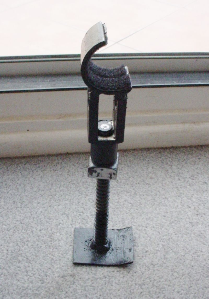

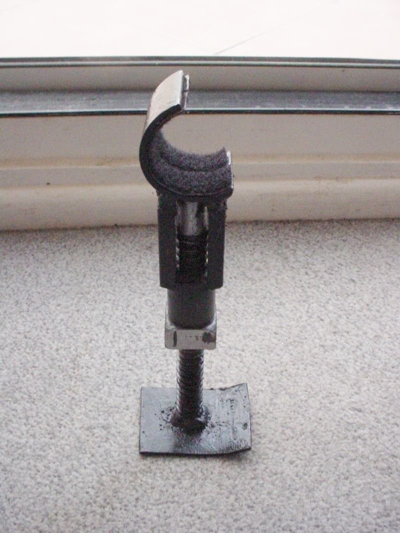

Hi forgot to say , i want my glove box for cake lol so i,m working on an aluminium screw jack based on an acrow prop ,super light and as bending and lifting are a problem for me i want to mount it clip on under the footboards along with appropriate wheel changing tools as its hollow they can sit inside my mate has borrowed my mig ,so its just big heavy lumps with stick lol
george

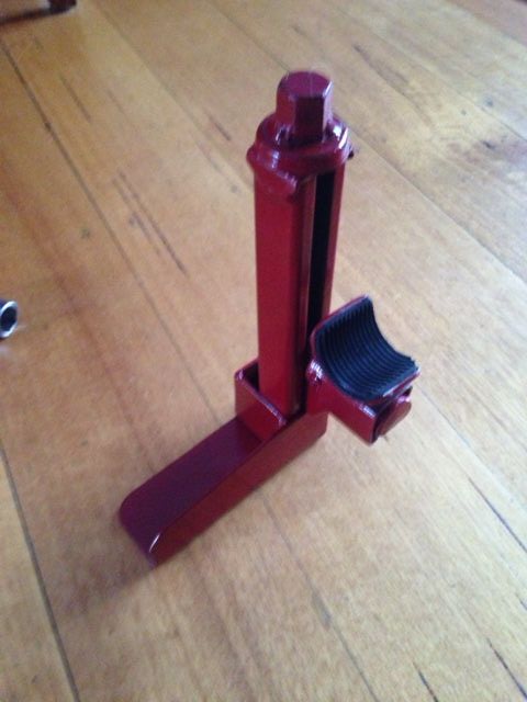

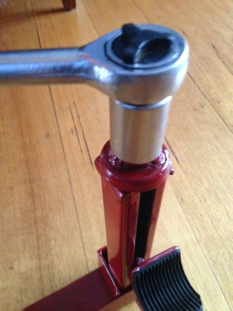

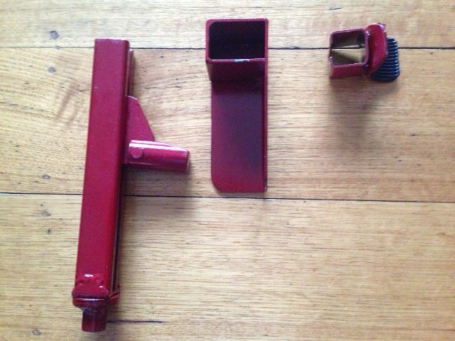

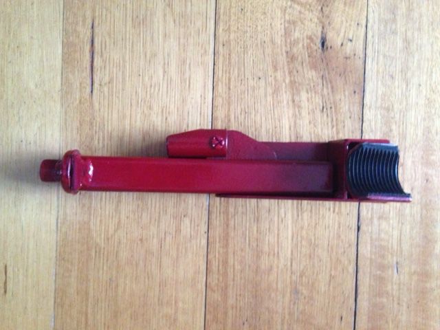

Here's one a friend developed for me. I learnt how useful a tool like tis in the glove box is the hard way with a flat in the rear of the PX in the middle of nowhere. It's made from a converted VW jack. The foot can be positioned in different positions to adjust for ground conditions. It works fantastically and packs up compactly too. A 19mm socket or spanner is all that's needed to raise and lower it.
Fitted together
Fitted together
The components
The components
The assembled jack
The assembled jack
19mm socket to wind it up and down
hi very very nice idea ,resourceful, ingenious,adjustable compact and i even like the colour A*...................................many thanks

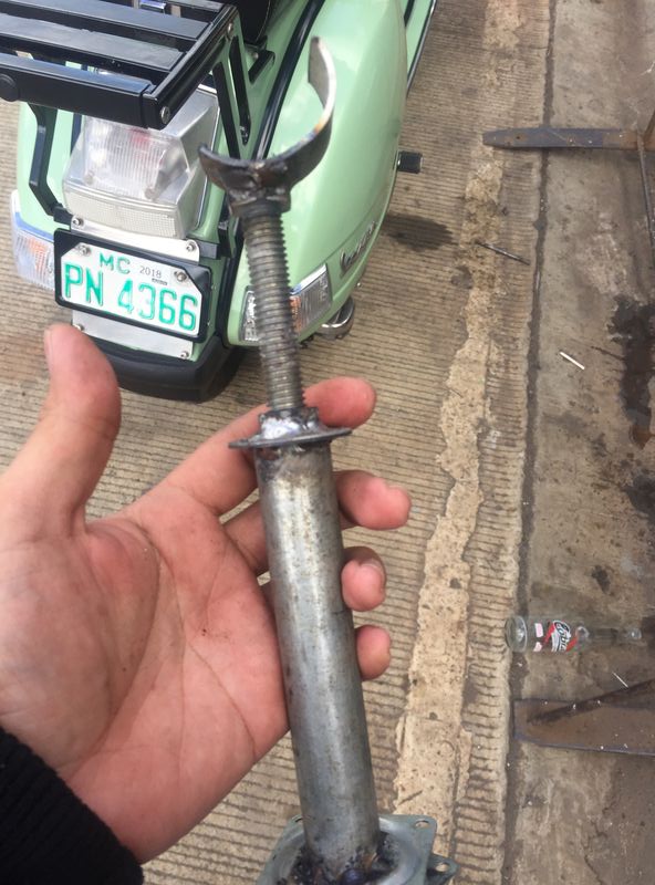

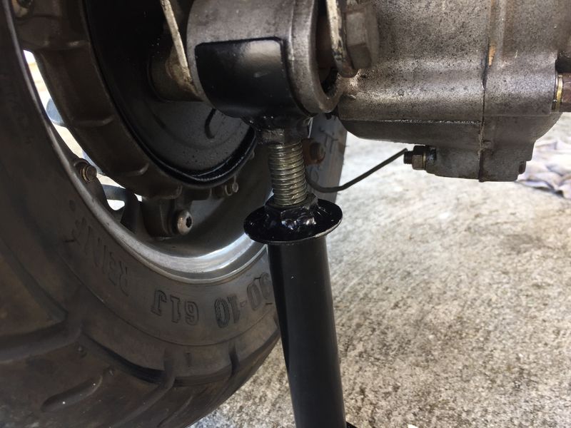

I used a can of orange juice in the past. But after I got this new (old) PX a couple of weeks ago, I realized I am not strong enough (nor willing) to lift the rear everytime I need to change tires. So I made this from scrap wood. I'm not surprised others have done similar and better jacks before me, but I'm still excited to see ingenious solutions to our common problem.
PX150 1997
Posts: 6
Location: Philippines
PX150 1997
Posts: 6
Sorry for flooding posts. I can't seem to figure out how to attach more than one picture. Anyway, the jack is made of a 5" piece of pipe, 5" bolt and nut, a susan bearing for the base. Operation is simple: the pipe acts as the grip. You twist it to push up or down the thread, no wrench necessary, a half-moon metal is welded on top of the thread.

Yeah. I, for one, am obsessed with minimalizing everyday-carry tools. I used a longer sparkplug wrench that acts also as the tire jack. But I don't feel that it's right to jack the engine under the gear box and jacking it up from the bottom of the shock seems right. Plus, when carrying top box, and with the tank full of gas, I don't like lifting the bike for even a bit. It's a compromise. But the next thing in mind is to make this jack more multi-tool than it currently is.

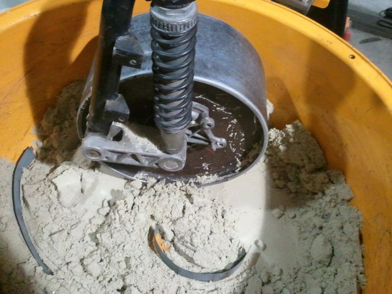

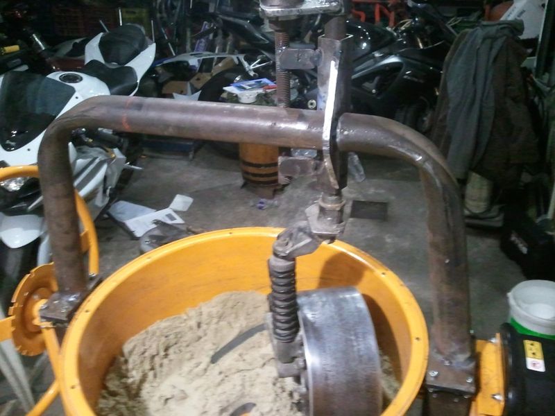

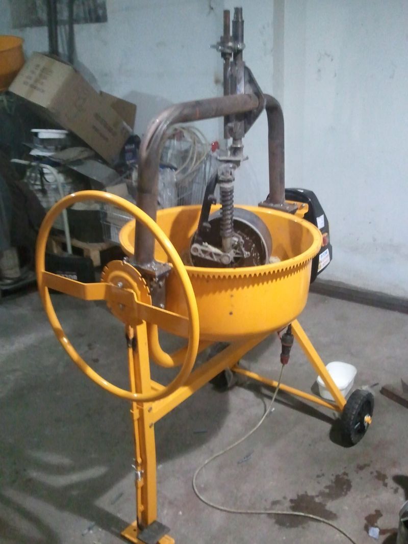

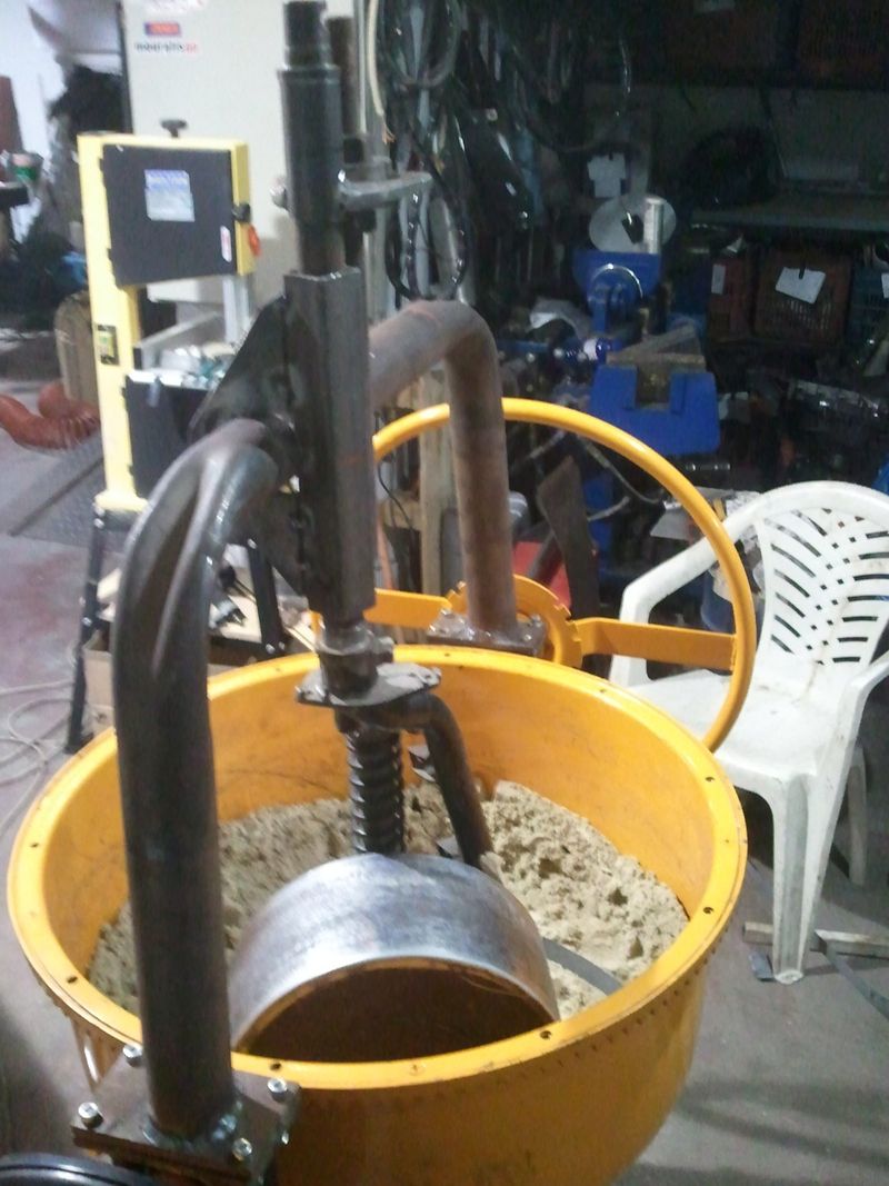

Not sure this fits in here, it is kind of backwards from the others. Not taking something else to make something for a Vespa, but we took something from a Vespa to make something else. We made a foundry sand muller using a concrete mixer like this guy did:
but didn't have to make an axle, wheel support or spring setup like he did because we had one laying around.
No disk brake forks were harmed here.
It could be unbolted, removed and put in any P, no welding to the fork.
But it wouldn't fit in my luggage, boo hoo.
No disk brake forks were harmed here. It could be unbolted, removed and put in any P, no welding to the fork. But it wouldn't fit in my luggage, boo hoo.
Tack welded for trials, very first run and it works pretty well.
2 Vespa big side rim halfs welded in a piece of big pipe make a cheap wheel.
Tack welded for trials, very first run and it works pretty well. 2 Vespa big side rim halfs welded in a piece of big pipe make a cheap wheel.
Templates for where we will set the plows to push the sand back under the wheel.
Brake disk replace by heavy sheet metal to keep the sand out.
Templates for where we will set the plows to push the sand back under the wheel. Brake disk replace by heavy sheet metal to keep the sand out.
Adjustable up & down(big screw) as well as angle of attack(slot to rotate fork)

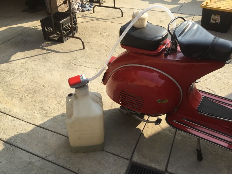

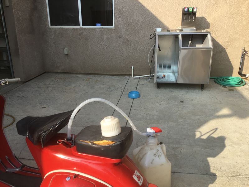

Attention all non lube auto vespas
For all you non lube auto Vespa owners. Tired of trying to put gas in your scooter in between the seats and spilling gas everywhere? So, for the pre-mix owners, this has been a great useful device. Pumps fuel from my 5gallon jugs into the ol vespa. Not a wasted drip of gas anywhere. It even has an auto shut off. Did I mention it was around 40.00.
Not sure how most people put gas into their vintage pre-mix scooters. I put the oil into 5gallon jugs and then fill the jugs. Anyway I thought it would qualify as a useful tool. That's all I have air bags and fuel pumps to make life easier while working on your scooter. Scott
