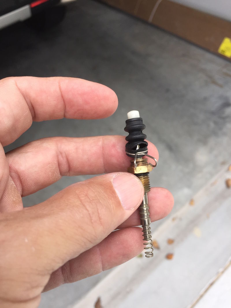

So I removed the carb, disassembled, gave it a good bath, then gave the parts another bath in my ultrasonic cleaner I use for fishing reels. Parts came out spotless. So far so good. When I went to re-assemble, everything went back together perfectly. I even figured out what the needle jet or collar was that I found in the bottom of the ultrasonic cleaner, and got it back in correctly. So at this point I'm getting drunk with power when I notice a split in the little boot of the plunger that seats in the float bowl.
Can someone please tell me how screwed I am? And if there is any way to unscrew myself short of buying the float bowl cover kit that has the little boot? I'd buy a new carb before buying the kit.
I've included a pic of the part. (No plastic or rubber when in the carb cleaner or ultrasonic. Just a little soap and water since it wasn't really dirty). In a perfect world, it would be great just to buy the boot, or even the plunger mechanism.

Any chance you could make a Harley boot cap work?

Very good idea. Maybe I'll swing by the local Harley shop looking particularly pitiful.

Looks like part of the accelerator pump. The rubber is there to keep the dirt out, but it should still work as is and you should be able to order that part alone.

Mine is split too. Bike runs fine.

Thanks guys. I was figuring it was just to keep out dust/dirt. I'm gonna install the carb to see if the cleaning helped. Depending on that outcome, I'll worry about replacing the boot. Or not.

Looks like it is available from Vespa, p/n 871855. Not cheap though, $12 for boot only.

The boot is not the reason your bike is dying, but if you want to replace it, just about every Chinese scooter made uses a copy of the Keihin CVK carb, and they all have rubber boots. Anybody who repairs Chinese scooters, and there are plenty in NC, will have a stack of bad carburetors somewhere, and will be able to give you a boot for very little money.

Thanks guys. Very helpful. And yes, the boot isn't the current problem. Just didn't want it to be a future problem. Won't have time to put the cleaned carb on till later in the week. Hoping that did the trick. If not, I'll be back for more advice!
