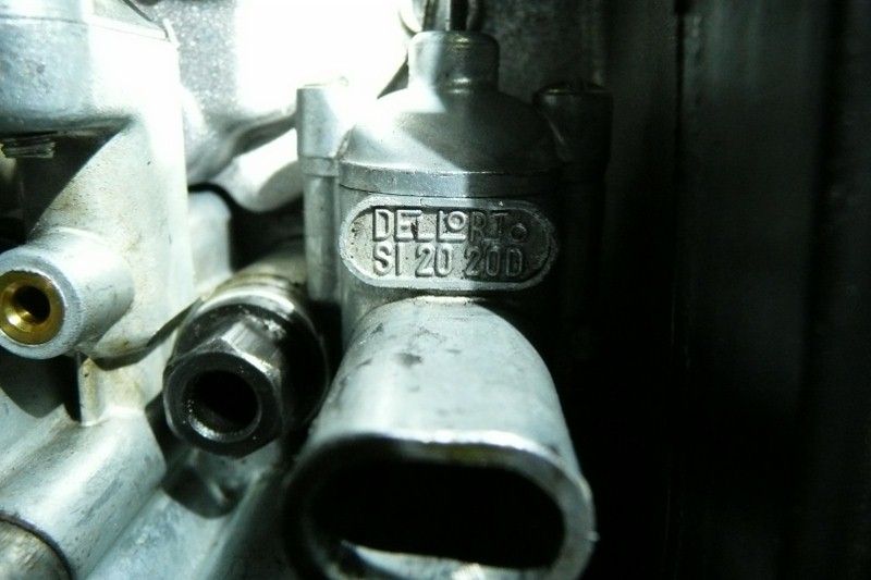

How do I find out which carb I have. All I can see on the cover is numbers and no name.

Take the cover off and look at the carb. There will be a number right under the throttle slide arm.
Getting a cheap LML 150cc cylinder would be worth the cost in my opinion. Someone probably has one on here used for a few bucks!
it should be stamped in like this...

What is a pollinivelociy vortexystem? I was on sip scooter shop website and they do main jet kits but I cant figure out what kit I need. My carb is a spaco si 20 20 d. I havd emailed them but hav nt heard back. Is the sip road 2 better thana revolver exhaust?
