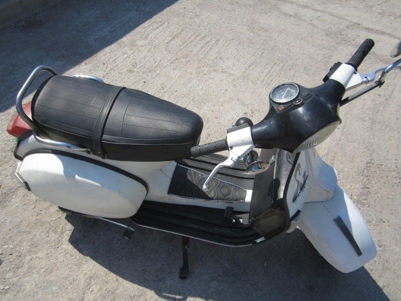

Hi Guys!
So i just bought my first Vespa some time ago.
A 1983 P200E its done about 25000 km.
But in very good condition and running really well!
However i would like to, have it a bit more easy/comfy to ride. Lets just say i wanna make it a little more modern.
I have some ideas of what to do, but im not 100% sure, and would love to hear your advice.
I'm not going for a faster bike - just a "better" one.
My thoughts so far is:
1. Change the clutch, to make gear shifts more effortless - which one would you recommend?
2. Install a front full hydraulic front disk brake
3. Install a new exhaust, since the old is rusty
And thats pretty much it.
What do you guys think?

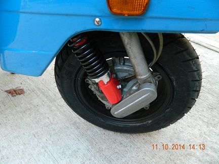

I agree with Xantufrog's recommendation on shocks. I have had my 1979 P200E for a year and 1000 miles on these shocks and they are the best addition that I have made on this scooter. I can also recommend the tubeless aluminum wheels and Michelin tires from Scootermercato.
The Carbone are a good value and a big step up from the stock wet noodles. Yes - there are even better shocks. But these will give you what you need at a comfortable price.
