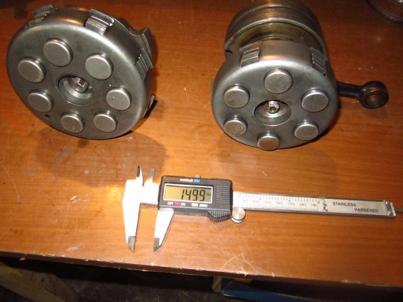

Saw your thread and thought they would be the same diameter, but wasn't positive. I had a chance today to check and found they should both be the SAME diameter, nominally 15mm, crankshaft and clutch bore. If you got the right clutch w/ 21 or 22 teeth it should work as Rob has pointed out.
I was able to slide a 6 spring 125/150 clutch on a P200 crank and likewise a 7 spring P200 clutch on the remnants of a 150 crank w/o any problem. Perhaps there are burrs on the end of the bore in the new clutch you need to dress down? If you have a pair of digital calipers, you could measure if that's not it.

if you have the proper 22 tooth version, you are probably hitting the case rib that is at 12:00 if you look at the clutch hole. grab it with a pair of vice grips, and snap it off. you can get a clean break, and you don't have to attack it with a dremil and fill your engine case with aluminum shavings.
you'll then have to dremil or grind down the corresponding rib on your clutch cover.
