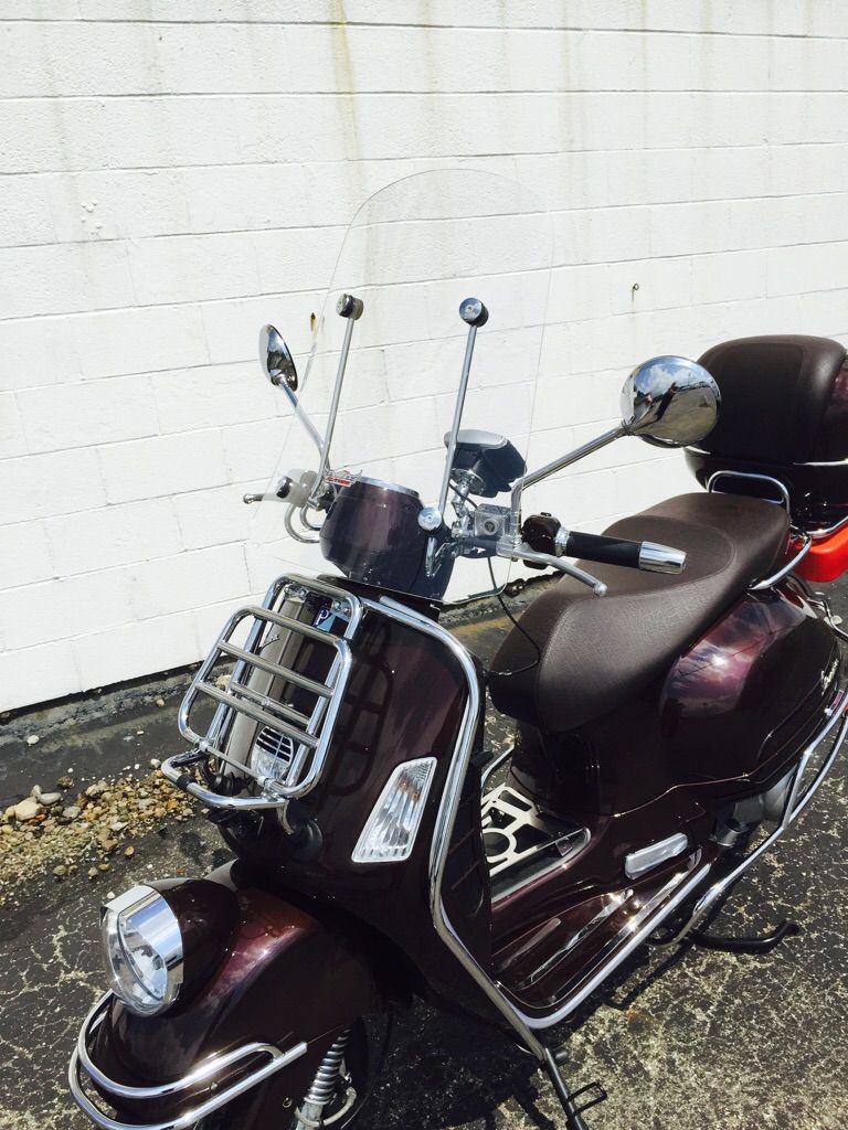

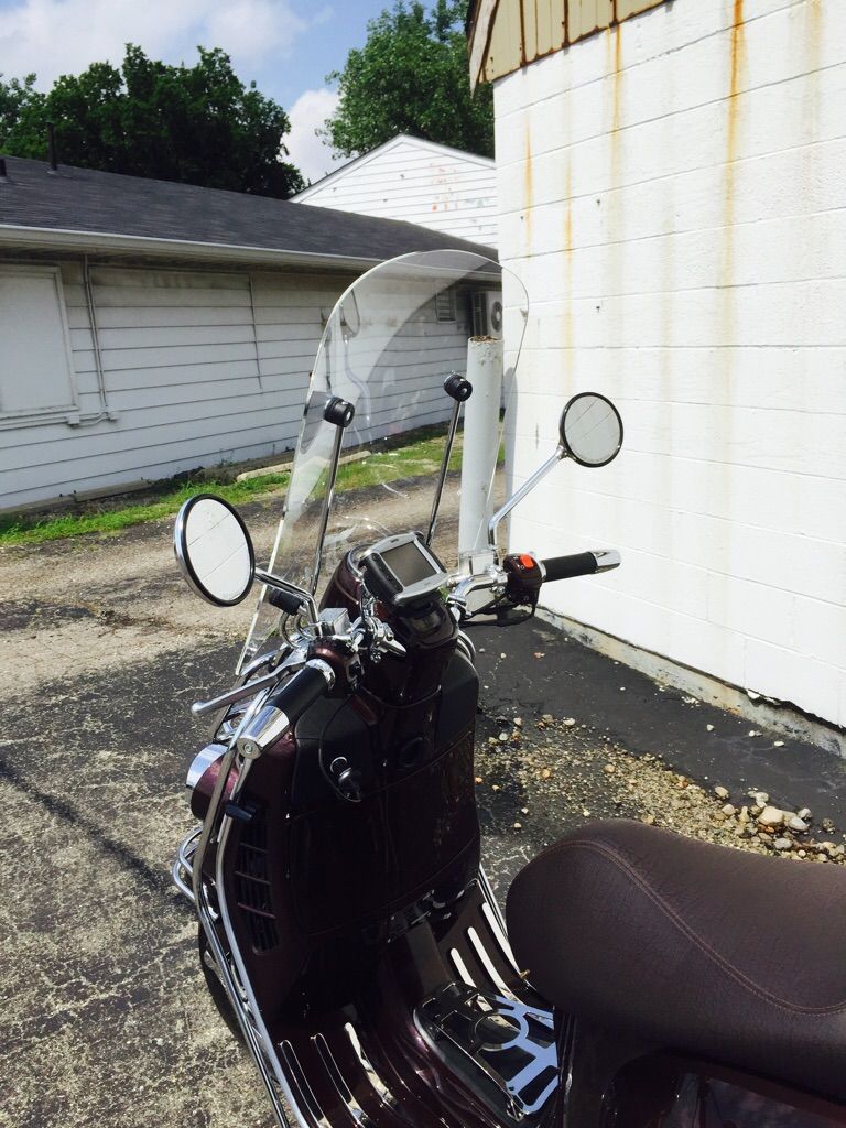

I made mine
From a 22 inch Honda GoldWing replacement blank from Slipstream. I searched too, but could not find one either. I am very happy with it. I used the mounts from my old full size screen. I'll switch back to the full screen in a few weeks as the weather turns colder.
