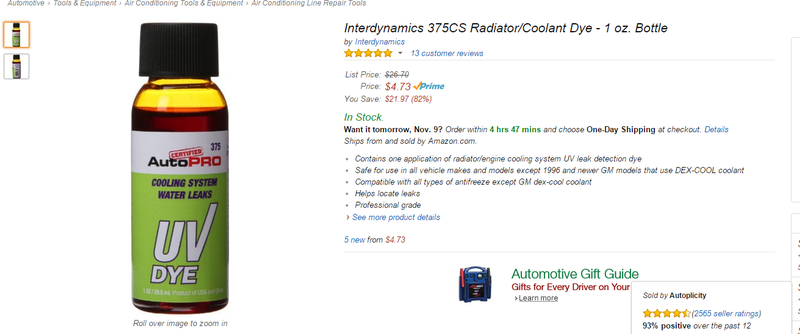

Wondering if there was anything equivalent to the UV/fluorescent dye used to detect leaks in air conditioning systems, a Google search found that there is such a thing at auto parts stores. Might try that.
@madison_sully avatar
Posts: 7699
Location: Madison, Wisconsin
Posts: 7699

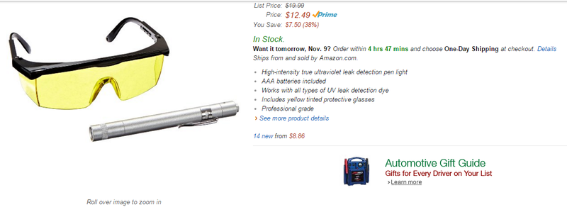

Hadn't thought of UV
So some dye and a UV light then....
Many thanks.
The dye (?).
The dye (?).
And a light to see it.  I guess I"m lucky it is no longer daylight savings time, so I can see the leak right away when I get home....

Thanks all!
Dye, light, and glasses are on order. Might come in handy for AC repairs, some day....
There are no puddles, drips, or any external signs. But, it is a very small leak so could perhaps be a pinhole in the radiator or bad seal in the water pump.
I'll give the dye a go, and if something visible externally is the source, will replace that and the hoses (oh, and clamps ). Time for a new water pump anyway, and thermostat too.

Alrighty, so I put 1 oz of UV dye into the system on Tuesday, and now we wait. My wife drove the car about 150 miles or so yesterday, and no sign of drop in level of coolant. So this may take a while. The longer the better as far as I am concerned.
I'll probably check it tonight with the UV light just for fun. It's dark out when I get home anyway....

Stromrider wrote:
Also worth checking the engine block core plugs, especially behind the block in the hard to see places. I had a core plug leak very very minor amounts of coolant over a six month period before I found it. Nothing ever present on the garage floor, no evidence that could be easily seen. The exhaust manifold and downpipe covered the area where the core plug was situated making it almost a no go area. But after putting the car over the pit and getting underneath, there it was. Traces of coolant that evaporated before it hit the ground. Once the system cooled down and the pressure had gone in the system there was no leak.
No I am saying use the modern test equipment (Dye) available instead of an old school pressure tester that still has you looking for a had to see liquid, so a dye is still needed in most cases.

The UV dye would not have helped in my own case. It still would not have been visible behind the engine block. Very close to the bulk head and hidden by the exhaust manifold, down pipe etc. Very hard to shine a UV light up there. Had to find my leak using mirror and very small torch. But the standard non UV dye in my coolant was just visible. I pulled the engine and fitted a new core plug (freeze out plug) since the leaks always get worse and it's easy to do. Coolant sealants are really just a valuable but shorter term measure.

Lots of helpful replies, so I thank everyone.
I put dye in about a week and a half ago, and since then the car has been driven a couple hundred miles or so.
No sign of leaks anywhere. Engine bay, exhaust, anywhere on the block or near the radiator. Also no drop in coolant in this time either.
I'd almost rather see something, then I'd have something to fix....
Oh well. Just have to keep driving it I guess!
