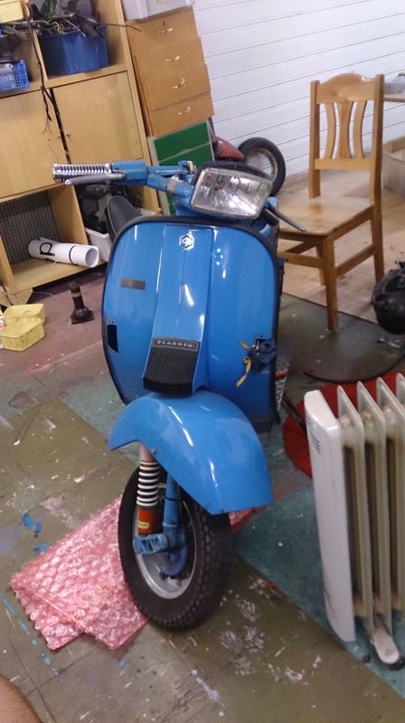

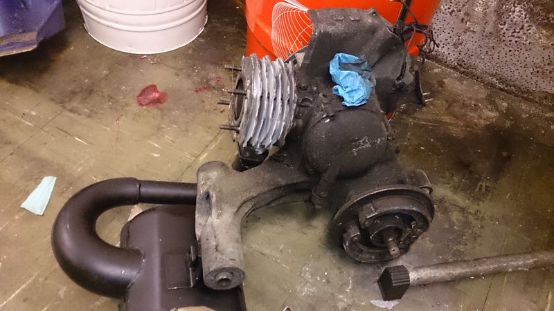

T5 with malossi 172, bgm big box. Dellorto 30 mm reed
21 cosa, kytronik. Droped handlebars
T5 nr 2: stock engine with sip road and kytronik 114 main. F.A.R moto driving screen
T5 nr3 px 200 malossi enginecase malossi 210 match ports, si 24/24
Bgm big box, kytronik my touring scooter
Primavera 125 polini 130 polini banana
19/19 carb
photos or it didnt happen

Have some photos of the scooter here

Delish
