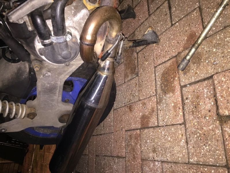

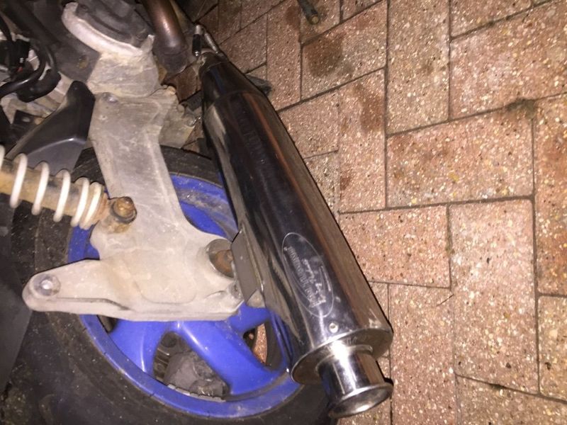

i have seen this PM tuning exhaust for sale and was wondering if it will fit my Vespa GTS 125! it says in the description it will will a Vespa 125 but doesn't state what model! Its is pictured on a gilera!
don't wanna spend £120 on an exhaust which may not fit!
thank you

It does look like the model for the gt's.... The pm 81(for the lx,s,et ect) is a lot shorter than that.... But like I said looks. Does the seller know which model it is?
That's missing its mounting plate anyhow, looks like the owner has simply bolted it straight to the bike. Id recommend getting a new bracket and then re working the bushing as they always fail.

Thank you for your reply! I have been investigating on the PM tuning website and after looming at the PM 68 it does say on the website they are for gilera so I am guessing it will fit! The seller is asking £120 for the exhaust which I think is a fair price as they are £300 brand new! How would you recommend I go about getting a bracket? Thank you

Buy one from PM Tuning. What the seller is asking seems like a lot for a used exhaust that's missing a major part and probably the rest of the mounting hardware as well. Before you buy it, shake it and see if it rattles. If it does, the baffle has broken off.
PM Tuning Exhausts are great, but they are loud, and you might have to remove it every time you want to change the oil filter.
